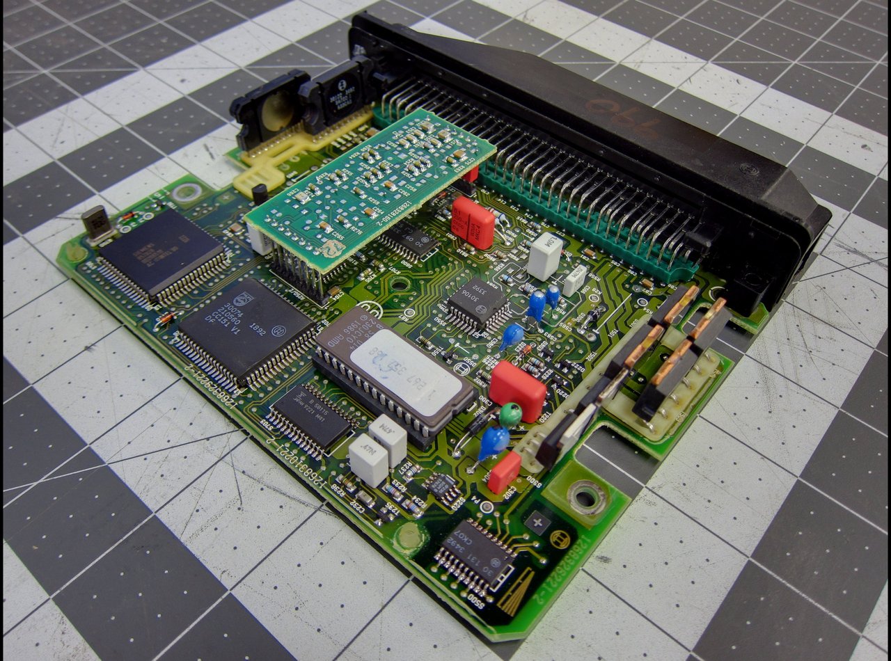

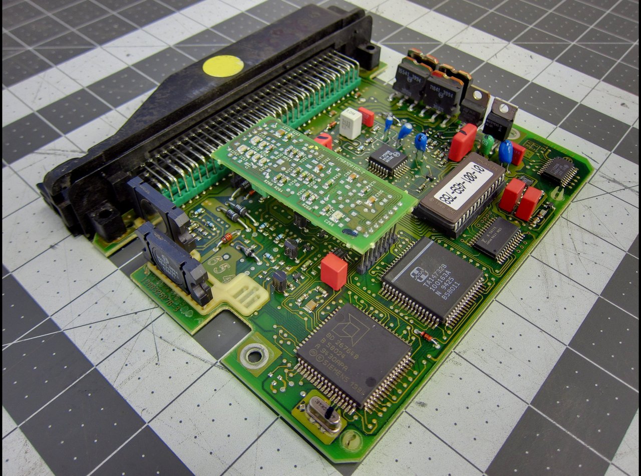

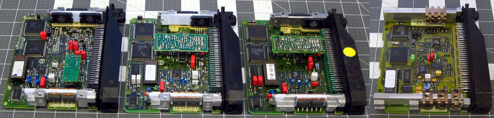

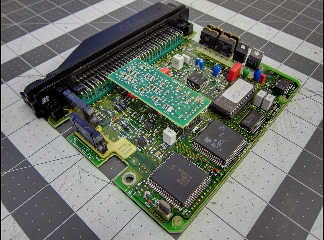

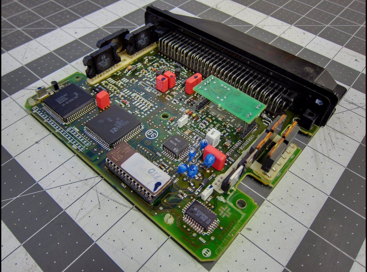

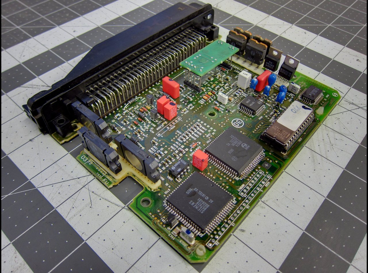

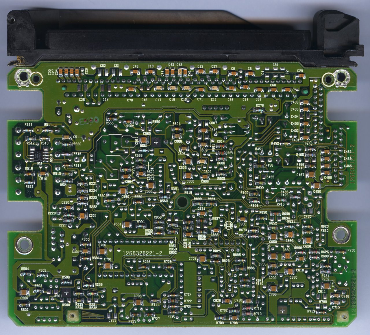

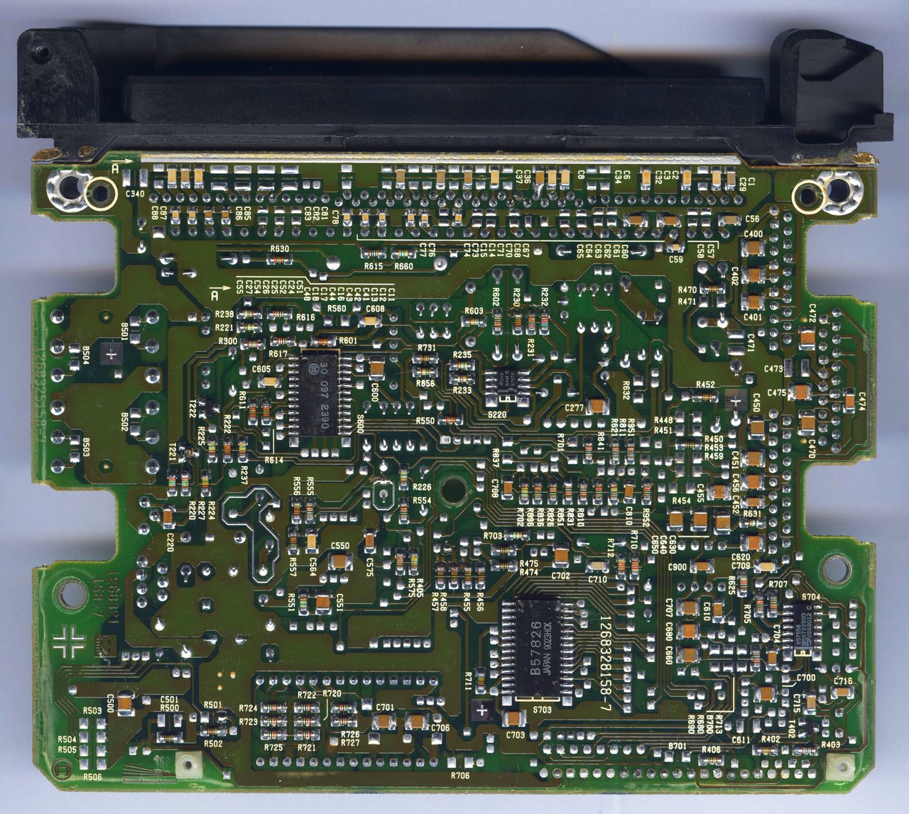

                  A couple of the eBay M1.7.2 units showed up today, so I took a little time to get photos of these just for purposes of documenting rough hardware differences. The 990 and 282 ECUs are not identical, with the most notable (to me) change being that the 282 unit eliminates all silkscreen reference designators. The M5.2 unit I have is also this way, so I guess that around the mid-90's Bosch decided to make things even harder to reverse engineer. If someone can think of a better reason why, I am all ears. Also, there are PCB layout differences between 990 and 282, with differences in components and the copper layers, although the layers do look ~90% the same.
                  When I receive the M1.7.2 0261203277 unit, I will add the same photos/views to this post.
                  The units next to one another. Bosch decided not to use thermal gap pads on the mid-current drivers in the 282 ECU, which is interesting to me (left to right: 175, 990, 282, 661)
                  Top view 1
                  M1.7 - 0261200175
                  M1.7.2 - 0261200990
                  M1.7.2 - 0261203282
                  M1.7.3 - 0261203661
                  Top view 2
                  M1.7 - 0261200175
                  M1.7.2 - 0261200990
                  M1.7.2 - 0261203282
                  M1.7.3 - 0261203661

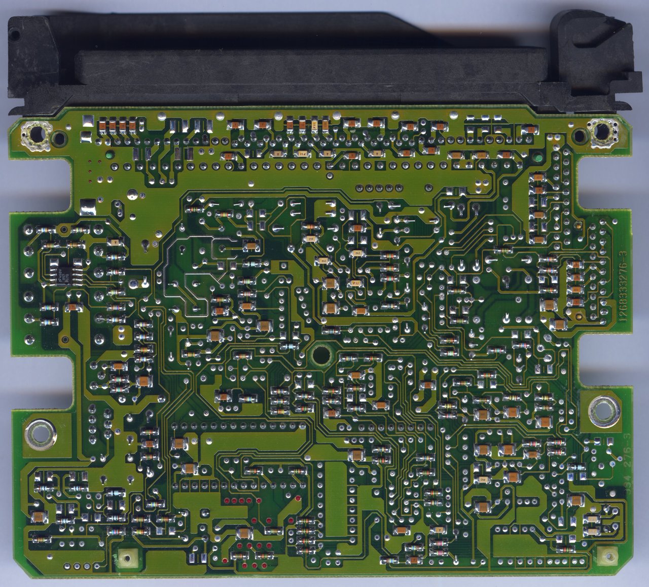

                  Bottom view
                  M1.7 - 0261200175
                  M1.7.2 - 0261200990
                  M1.7.2 - 0261203282
                  M1.7.3 - 0261203661

                    Good comparsion!
                    Perhaps there it was no longer necessary to publish somewhere schematic (maybe partially) for repair and no need make reference designators.
                    It's unlikely that a monopolist like Bosch would have to be afraid of competitors (in mid-90's there only Siemens could be considered as same, today, however, nothing has changed)
                    especially reverse engineers, which even after 30 years is not so much.
                    Although some communities of open systems would do well to simply "take and copy" proven solutions of those years...
                    I think is just for saving money, with a layman's eye (me :) ) PCB looks like same (software too, without any serious changes).

                      True, at that point maybe they finally had digital schematics and did not need big hand-drawn papers anymore. Are all of the M1.7.3 units made with no component references printed on the board? It's OK if they are, but it will make reverse engineering them a little bit harder since I will have to guess / invent reference numbers.
                      The differences in the PCB are in a few places. M1.7 and M1.7.2/990 have jumpers tying different ground networks together (metal enclosure, ignition drivers, everything else) and M1.7.2/282 has just joins the copper layers entirely. In the case of the older Motronics, this would actually make for separate ground terminals on the 88 pin connector, and I assume that they did this to leave themselves the option of using multiple ground points if ignition currents caused signal issues. But, since by the mid-90's they must have realized that this would not be an issue, they just tied everything together in copper. That is just one difference, there are others. The images I posted are less than half the size of my originals, and I also spent a little time holding the boards to look for differences.
                      Ultimately, it is not important since it sounds like all of the functional bits are effectively the same. Firmware from any M1.7.2 can be used on any hardware version and still work properly, correct? I know that there is not much use to documenting this, but since there has been so little information posted on these units for so long, I feel like now is the time to shine light on it once and for all. The 6-cylinder BMW's have had 90% of the attention (for obvious reasons), but I am into the 4 cylinder cars, and a little crazy, so it's time to open this stuff up for the community.
