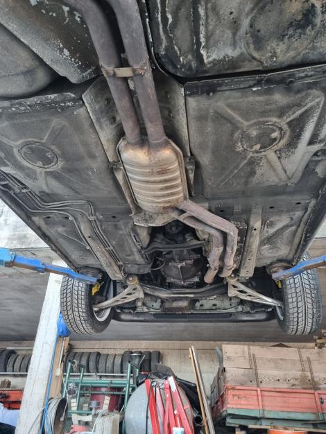

    My current issue is the exhaust setup, its a total waste, looks like it is the original one from the 330i donor cor plugget and weldet under the car in somehow.

    I already went to a exhaust builder in my region, but they are asking me 1500€ for just the piping connecting to the original E46 muffler that is already on the car... and I really dont like that design.

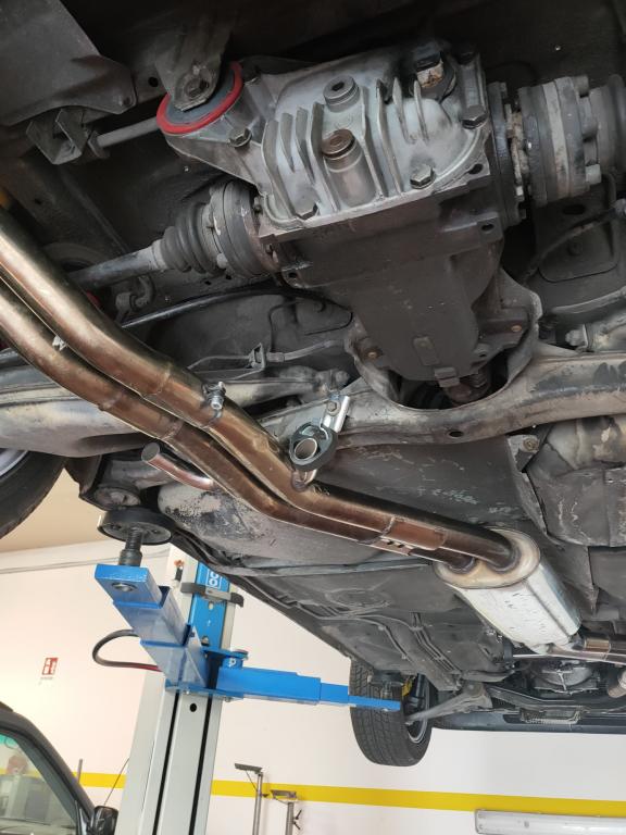

    Almost any reasonably priced exhaust for a swap is going to pieced together from two different cars.
    What is it you don't like about this one? It doesn't look that bad to me.

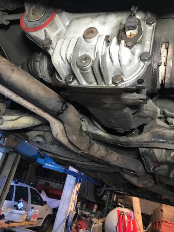

          it is way worse than it seems, its touching everywere. The muffler is touching the diff, and infront its touching the heatshield.... also the muffler is ugly because its the original E46 design. Long story short, to much work to do, so i would rather prefer to change it completely since I had to take it off anyway due to the rework of the Diff. Attached a picture, then your will understand =)
          You are aware if the E30 M3 exhaust hangs under the Touring chassi without issues? Is it the same pipe routing? That woudl mean that we just have to connect the collector to the flange from the M3... woudl be less work. also I think the 2" diameter would be enaugh for the engine.

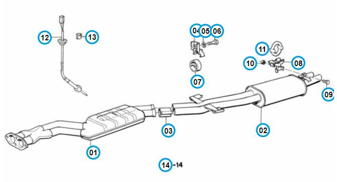

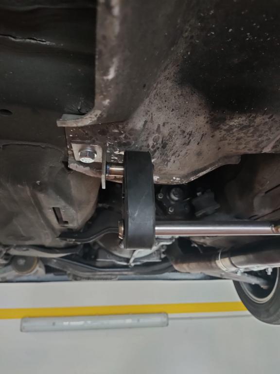

              Anyone has an idea where the original m3 exhaust hangs on? I mean the supports on the body? Because seems that my e30 chassis does not have the same supports, so i need to get the M3 once and weld them on the chassis. The issue is only that i can't find what I need. Like on the pics, 7+4 is clear, and i suppose that 7 is srewed on the rear axle/diff holder? But 08+11 is hanging somewere and i cant find that part? anyone help out there?
              • moatilliatta
                • 6157
                2 on subframe, 1 on chassis in the middle of spare wheel well and trunk side pocket.
                STD E30 has better mounting. I’d try and use the E30 muffler hangers if they fit the muffler.
                If not expand or cut down, weld.

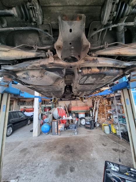

                  on the subframe (the diff holder) i have only one hanger point (see picture) therefore i need to weld on a second hanger for the m3 exhaust (and i dont get it which one it is to weld on).... on the muffler i agree, might make more sense to welt a support and hang it on the 2 standard e30 once

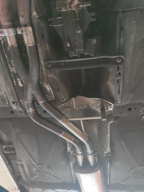

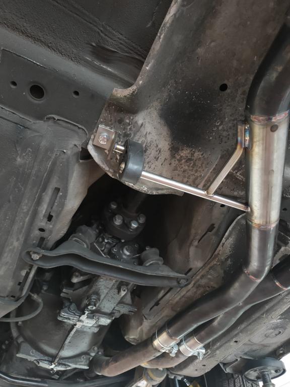

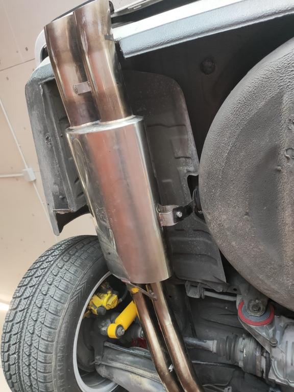

                    So this is my final result picking up an Exhaust from an E30 M3.. it didnt fit in any way so we had to modify everything....
                    Big amount of work.... better do do it from 0, becasue the exhaust wasnt for free at all...
