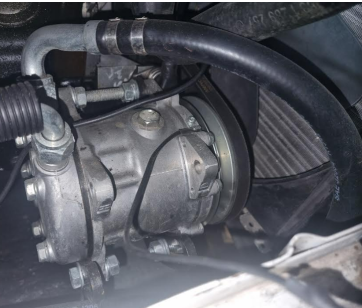

          I don't have a turbo (yet..), but I put a modern Sanden sd5h09 compressor on my m20, significantly smaller than the oem one. So if you are light on room I would get one of them and if you make your own brakcet you can put it lower. I made my bracket quite low compare to oem, so there is alot more room around the exhaust area (I figured best to keep AC things away from the exhast...). and you can make new lines to really get things out of the way.

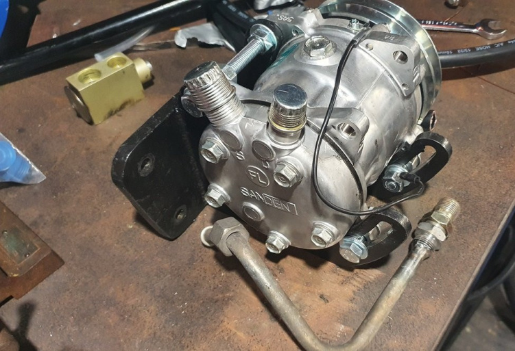

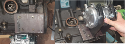

            • e30davie
              • Apr 2016
              • 1788
              Couple of photos I found, bit of steel and I found a hot rod place that sold the mounting arms welded together and painted black. I could make you one but shipping from Australia might be a bit high?
                Yea probably not worth shipping from Australia. The pictures help, I think I might be able to fabricate that. If not I did find this in the US, for $170, just not sure the fitment would be good for turbo, looks like it mounts it high and the overhead bracket would get in the way. https://lcwylieco.bigcartel.com/prod...ersion-bracket

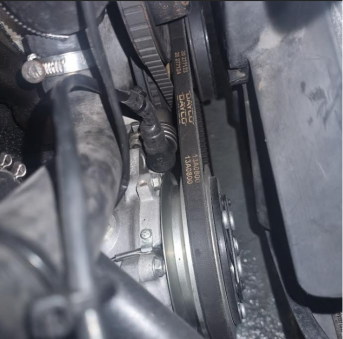

                  • e30davie
                    • Apr 2016
                    • 1788
                    yer i saw the LC wylie brackets, and were somewhat of the inspiration for mine. with shipping and the exchange rate one LC wylie was not economically viable for me. These are the sliders I bought locally, and I just got a bit of 8mm plate for the backing. surely someone in America sells something like this? a hot rod place perhaps? or yer just cad it up. the radius of the adjustment slot just needs to match the dimension between the ears.
                    https://store.autofrost.com.au/index...roduct_id=2118
                    You just have to be careful of the crank sensor. I'm not going to lie i forgot to take it into account on my car, but by shear luck it fits...just. I should redo mine one day, but its been working fine for years.
                    I made another bracket for a guy here for the same compressor on an m20b27, and I just welded on the brackets ~30mm lower. But i don't have any photos of his I'm afraid. but access to the crank sensor wasn't an issue with how i made his.
