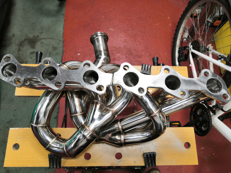

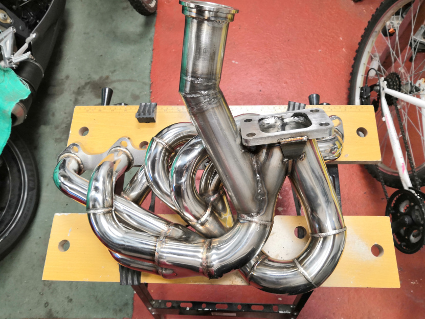

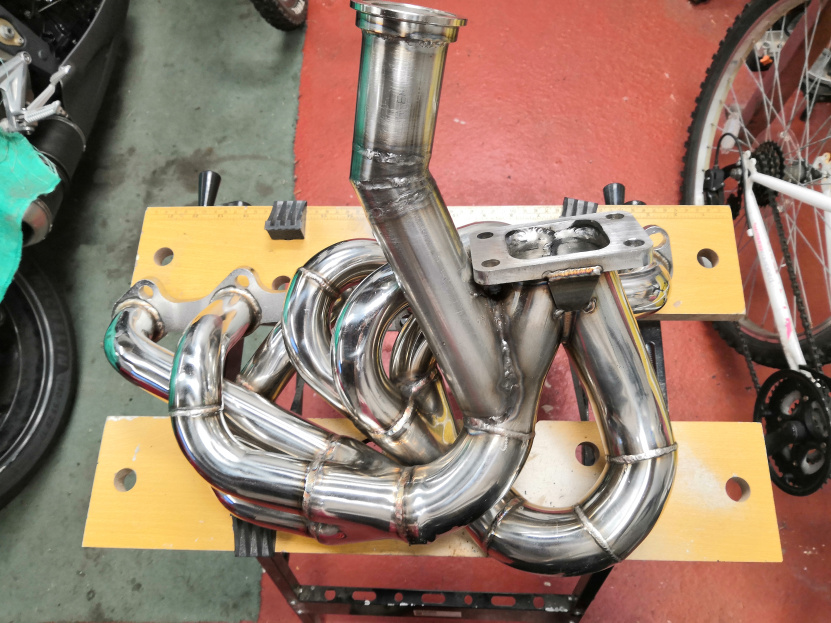

        I used this manifold when I first put mine together. Awful fit at the head, had to split the flange and elongate all the stud holes to make it fit. Needed an turbo flange as a spacer so the turbo would clear the rocker cover as well. Doesn't have a wastegate port either so I added one, surprisingly had zero creep, could hold my 16cm HX35 at 7PSI. Also it's not twinscroll.
        https://www.schmiedmann.com/en/bmw-E...ct=TURBOMANM20​
        I'm in the process of switching to The Kangaroos manifold at the moment to get twin scroll and exhaust ports that actually line up with the head. Fits perfectly, but as you say it might not flow as well. I want the twin scroll to help spool on my 16cm housing. Also, the wastegate port isn't at a good angle, so I'll have to see if it creeps.
