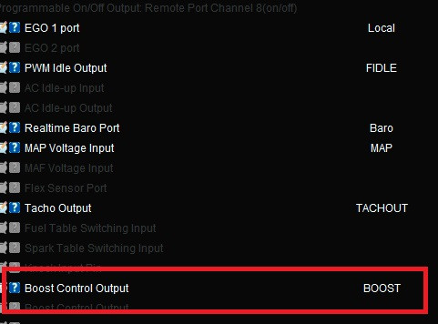

    screenshot from Tuner Studio "Feature list showing i/o pins", this means it sees the EBC right?
