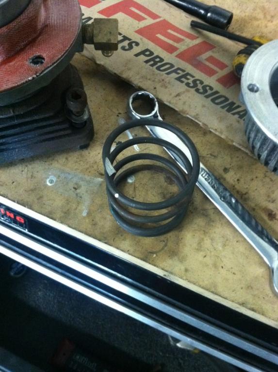

    So this is the wastegate Im working with
    http://www.ebay.com/itm/Universal-40...ht_4141wt_1398
    You think any 40mm spring would be good? Im just scared to run whatever spring is in there now and blow up my motor

  • Jafxod
    replied
    Heres some pictures
    Leave a comment:

  • Jafxod
    replied
    Build is coming along great so far. Ill get pics up tonight
    So I have this large wastegate that has a big 4 flange flange that bolts it up to my manifold. The spring diameter is 51mm(ish) and it seems to have been cut short so its only 4 coils tall. There are traces of green paint on it. Anyone have any information about what i should do. the only springs that large I could find are like 4 inches tall, mine is about 2.5 inches tall. I just dont wanna boost more then my stock headgasket can take for now. What would you niggas do?
