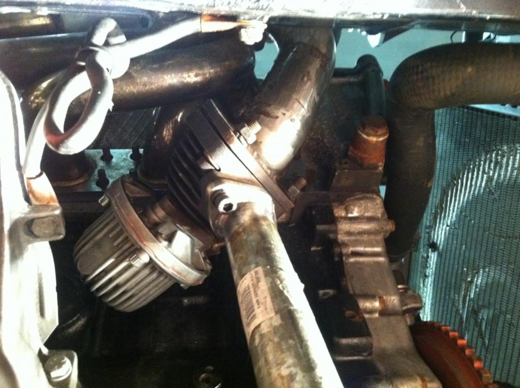

    Wastegate dump is now routed down to the ground, downpipe is finished and ready to drive to my buddies shop to finish the exhaust on his lift. What do most people do for catch cans? Location? Which lines do they tap into?
    I talked to WAR and they said they have nothing for Non Vanos turbo's WTFFFFFF I dont even know what to do now fuck.

    Tacked up the downpipe last night, my buddy tigged it all together today. Looks closer to the valve cover then it is. Still gonna build a heat shield.

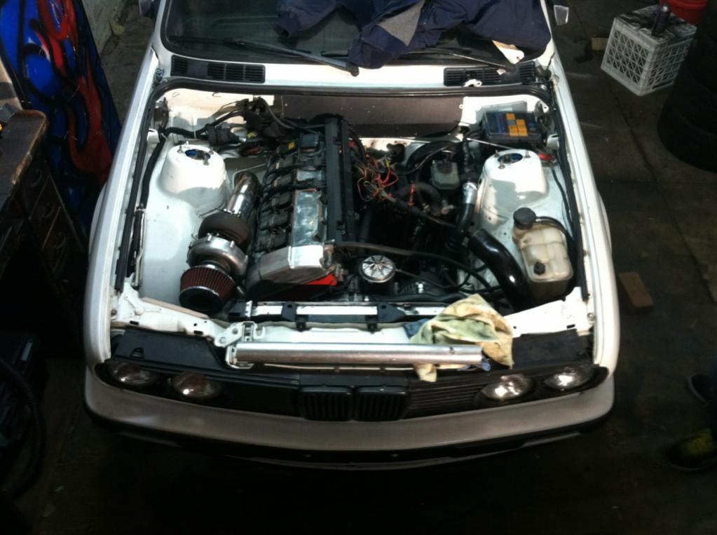

    Anyone know what kinda threads/fitting I need for the oil feed off the oil pressure sensor.
    Decided on going megasquirt. Should be worth it in the long run. Biggest things still left to do is grab some injectors. I was gonna go with 30lbs ones, unless anyone has any other input on that. I need to fab up the down pipe, piping from turbo to manifold, and lengthen the piping from intercooler to throttle body becuase i wont be running a MAF with MS.
    pics
    E36 bottom mount ebay manifold modified for top mount and reinforced to shit with external wastegate provision.
    Also got the intercooler in there really solid, would not hesitate to drive this with out the valance, which is gonna happen a few times obviously haha.
