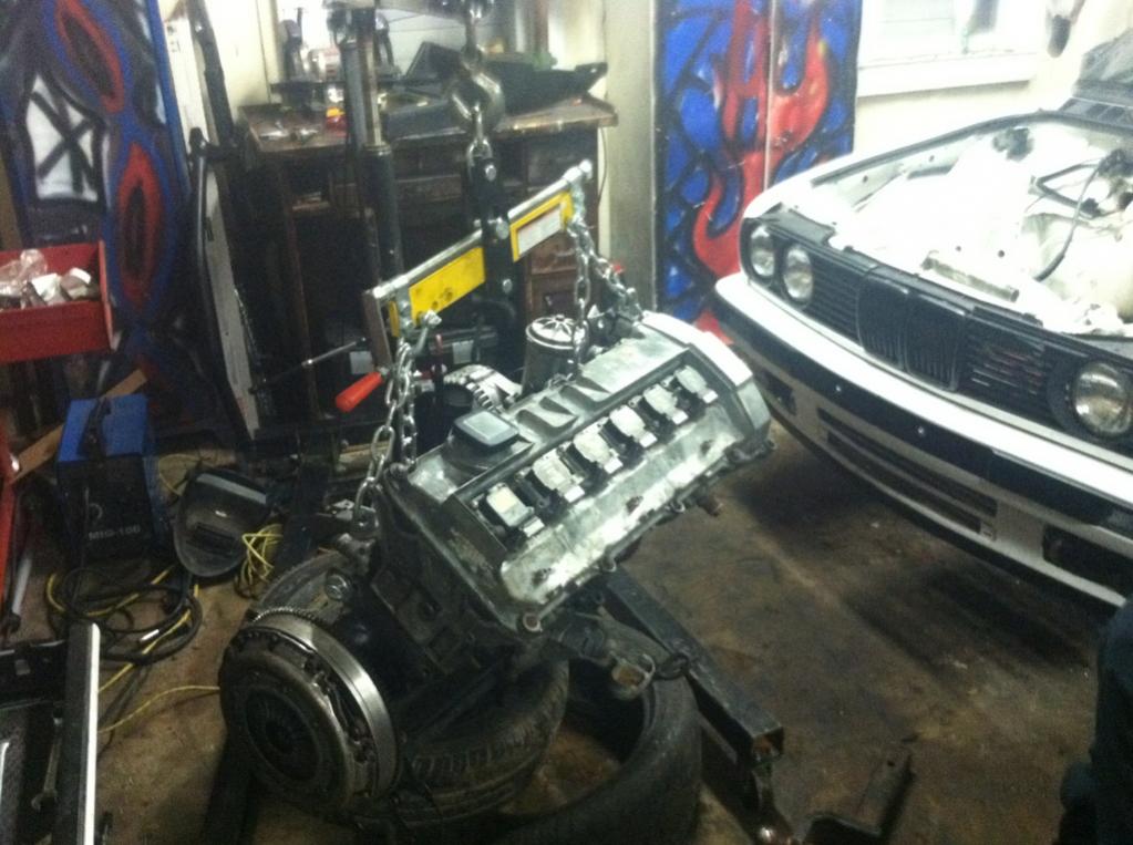

Heres some picture updates for you guys. Also, my buddy chris is now occupying the other half of his garage with his e36 m3 turbo m52 build with a 61mm turbo with a 550whp target. Should be interesting.
Pulled my motor to clean up the bay and motor, tap the oil pan for the return and bolt on the manifold I made.
