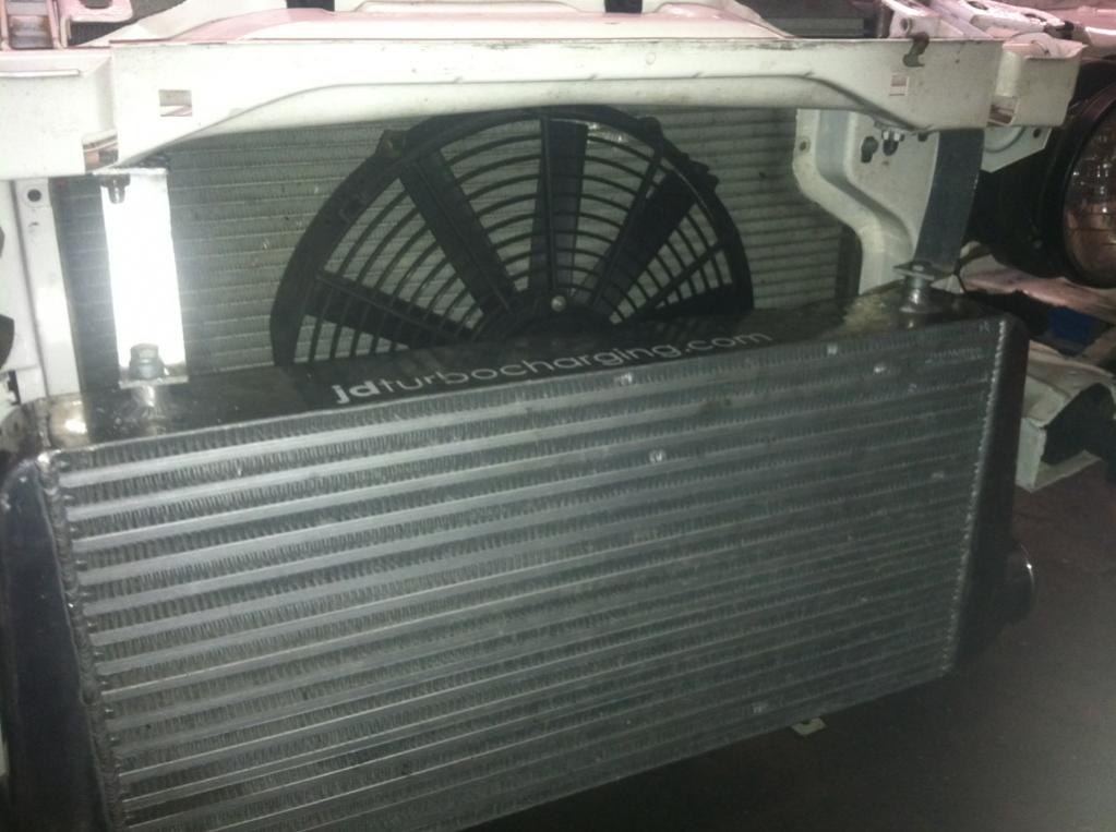

              Manifold is welded up, intercooler is mounted.
              Im wondering if I need to run the rrfpr if I run MS.
              It looks like im gonna get someone to build up a MS setup for me and then get it tuned. Sounds like its the best way to go.

                You should still run an adjustable FPR so you can play with that for tuning capabilities. Otherwise your limited to what the stock FPR is pushing & something tells me your gonna be going above and beyond that lol

                  Good call. I most likely will. Once i get money for for ARP studs and a MLS head gasket this thing will be retarted, but I wanna start off safe.
                  Anyone know what kinda threads/fitting I need for the oil feed off the oil pressure sensor.
                  Decided on going megasquirt. Should be worth it in the long run. Biggest things still left to do is grab some injectors. I was gonna go with 30lbs ones, unless anyone has any other input on that. I need to fab up the down pipe, piping from turbo to manifold, and lengthen the piping from intercooler to throttle body becuase i wont be running a MAF with MS.

                  E36 bottom mount ebay manifold modified for top mount and reinforced to shit with external wastegate provision.
                  Also got the intercooler in there really solid, would not hesitate to drive this with out the valance, which is gonna happen a few times obviously haha.

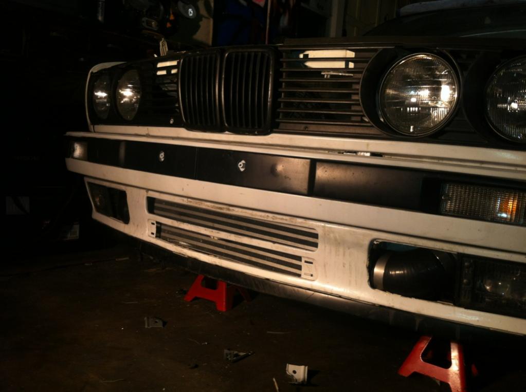

                          #57
                          Wasnt easy but tonight I went from this
                          to this

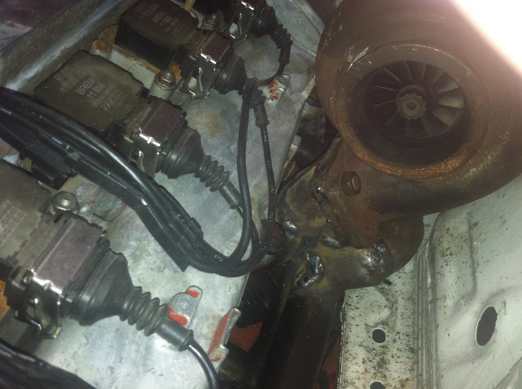

                                #60
                                Tacked up the downpipe last night, my buddy tigged it all together today. Looks closer to the valve cover then it is. Still gonna build a heat shield.
