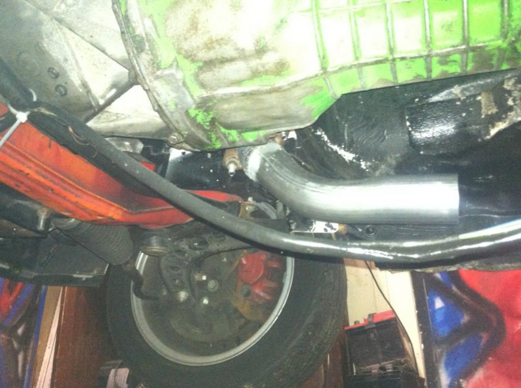

            Wastegate dump is now routed down to the ground, downpipe is finished and ready to drive to my buddies shop to finish the exhaust on his lift. What do most people do for catch cans? Location? Which lines do they tap into?
            I talked to WAR and they said they have nothing for Non Vanos turbo's WTFFFFFF I dont even know what to do now fuck.

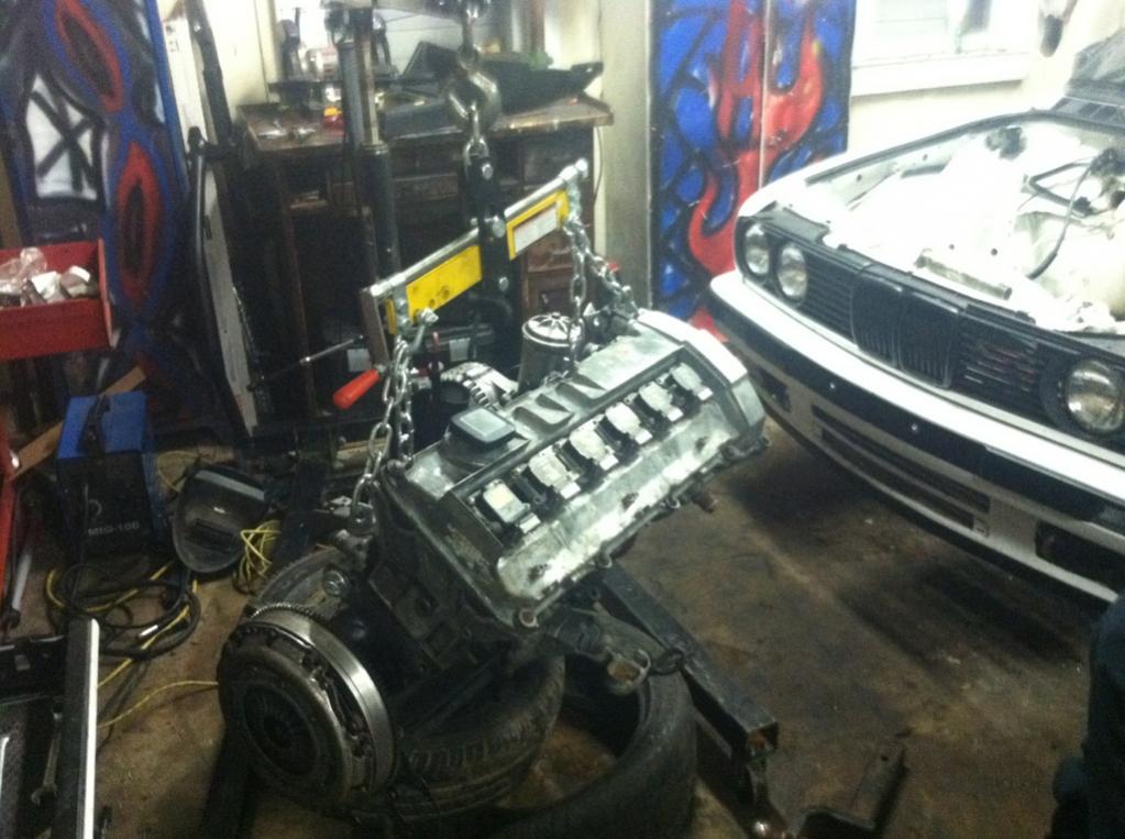

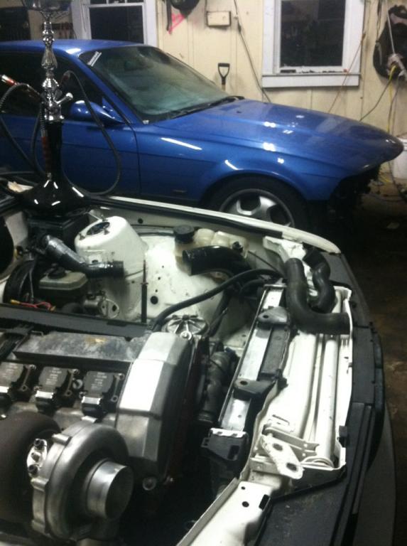

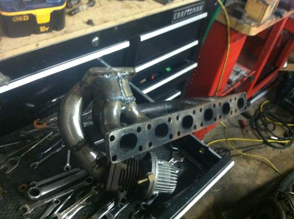

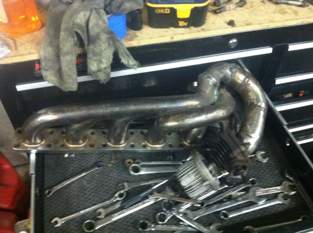

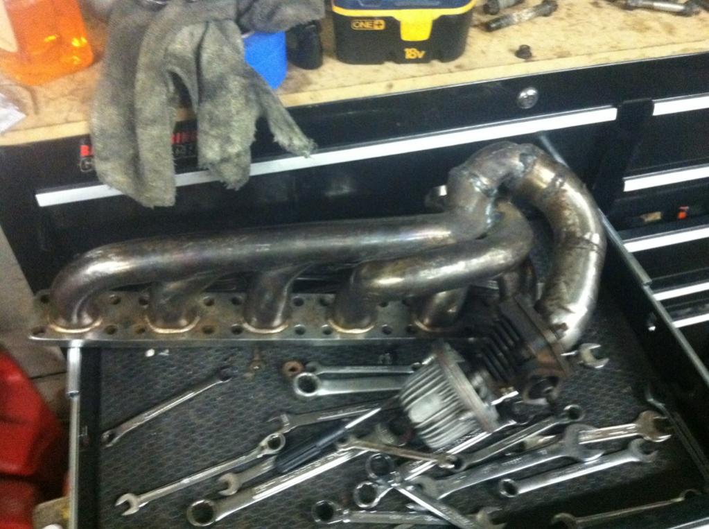

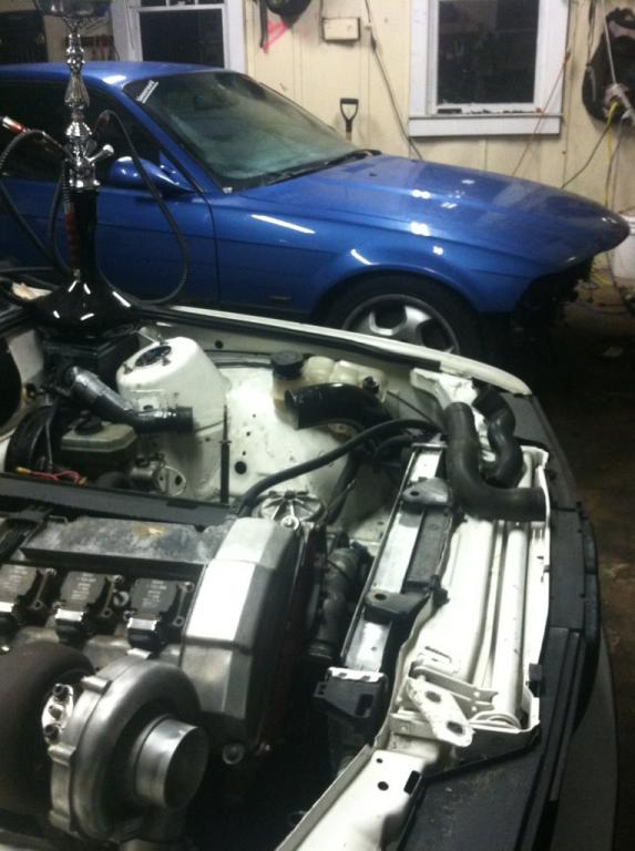

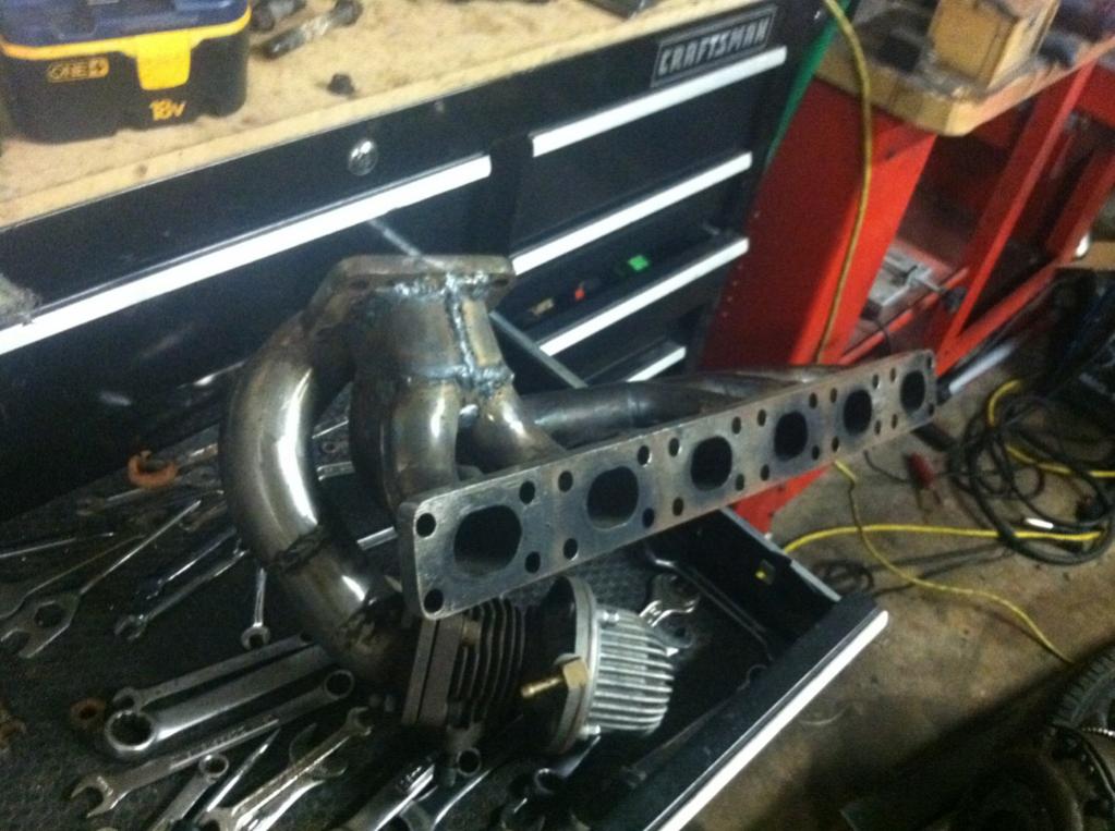

                                #75
                                Heres some picture updates for you guys. Also, my buddy chris is now occupying the other half of his garage with his e36 m3 turbo m52 build with a 61mm turbo with a 550whp target. Should be interesting.
                                Pulled my motor to clean up the bay and motor, tap the oil pan for the return and bolt on the manifold I made.
