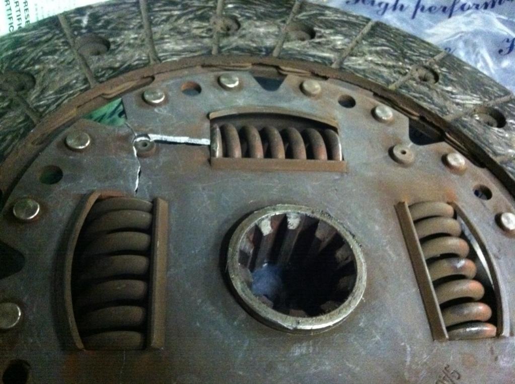

                Idk if that picture worked, linked it from my email, here it is again. Its e28 m5 clutch with good life left that I have been running with my m50 for the past year. I guess all the clutch kicking was to much for it. My buddy has another clutch he said I can snatch.

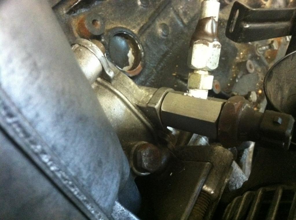

                  So I have this large wastegate that has a big 4 flange flange that bolts it up to my manifold. The spring diameter is 51mm(ish) and it seems to have been cut short so its only 4 coils tall. There are traces of green paint on it. Anyone have any information about what i should do. the only springs that large I could find are like 4 inches tall, mine is about 2.5 inches tall. I just dont wanna boost more then my stock headgasket can take for now. What would you niggas do?

                        So this is the wastegate Im working with
                        http://www.ebay.com/itm/Universal-40...ht_4141wt_1398
                        You think any 40mm spring would be good? Im just scared to run whatever spring is in there now and blow up my motor

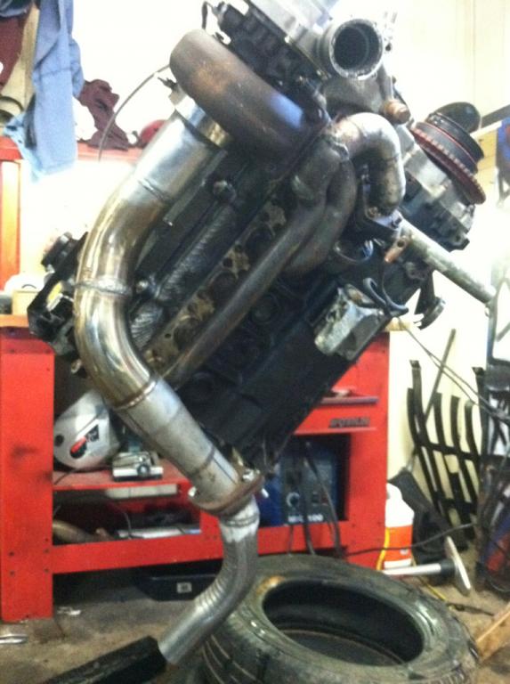

                          i wouldnt be combing different brand springs with different brand wg bc each wg is designed differently. however that lower exhaust bend the crushed ones will cause some unnecessary back pressure
                            Yeah most likely gonna buy a whole new wastegate, not worth the risk. Also plan on redoing everything from the downpipe back.
