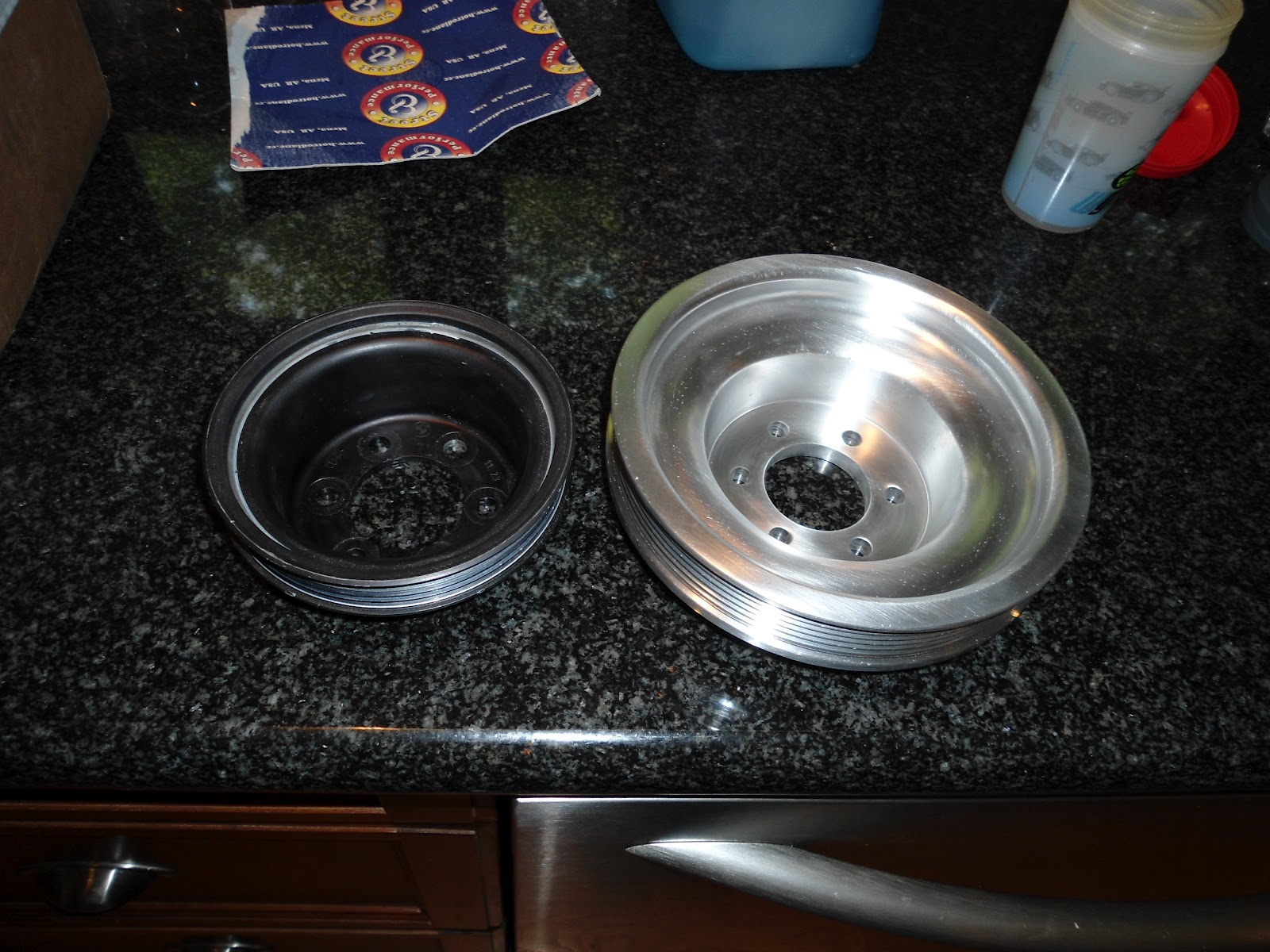

      I just approched another fabrication company to make me a custom crank pulley for the M20 engine following the M50 design but instead of 5" diameter go to 7" in a 6-Rib design.
      Reason is to increase boost from 4.5PSI to around 9-10PSI.
      I also having 10 custom bracket built to exact specs as mine.

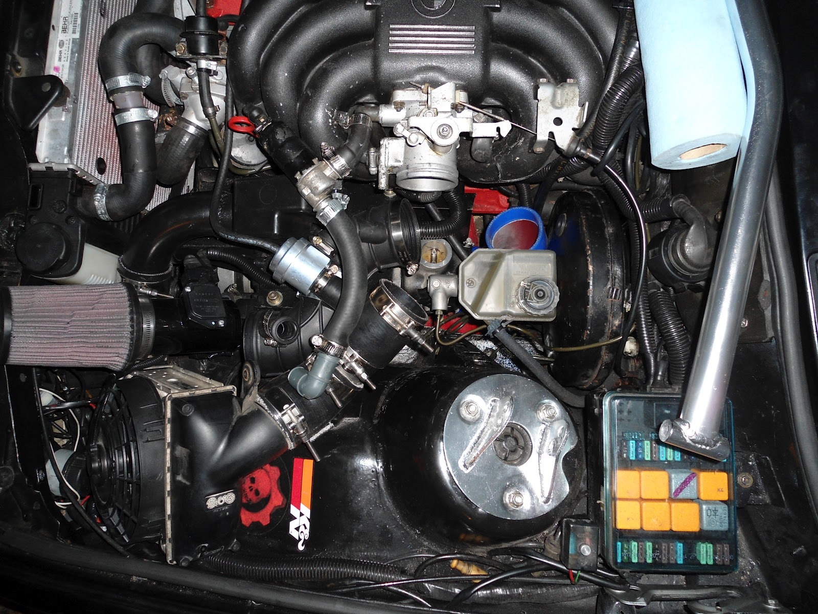

                    Almost done with Power brakes. It is quite the job as I had to remove the MC, redo the brake lines and redo the SC intake (still waiting on 3" flex to install)
                    Also had to weld brake pedal tab to connect brake
                    booster.
                    So I just have to finish the piping for the SC, adjust brake pedal.
                    I will probably mount the air filter in one of the kidneys and plumb it using the 3" flex I got in the mail. Should be better anyways for removing the air filter from the hot under hood temps.
                    When all this is done I move to the electric Power steering.

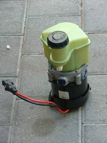

                      With Problem number 1 resolved: Power brakes installed.
                      Sooooo in order to safety my car in QC and keep my Supercharger system at the same time I had to find a solution for my problem number 2) Power Steering.
                      Well they want Power steering....well they will have it :) Great seller on ebay called pontiac442 made me a good deal on this used pump from europe, its in the mail, oh and its Electric all in one makes for a clean clean underhood.
                      Meanwhile I will get ready for this project I cant wait to get started... this is an amazing option for E30 owners. Stay tuned...
