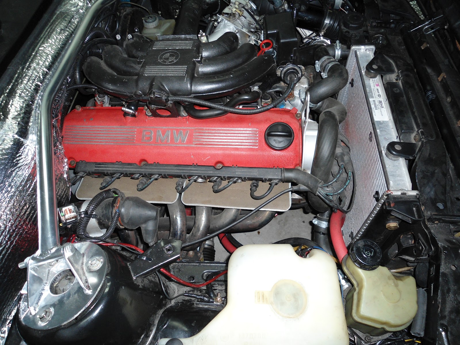

part 1 of my F/I M20

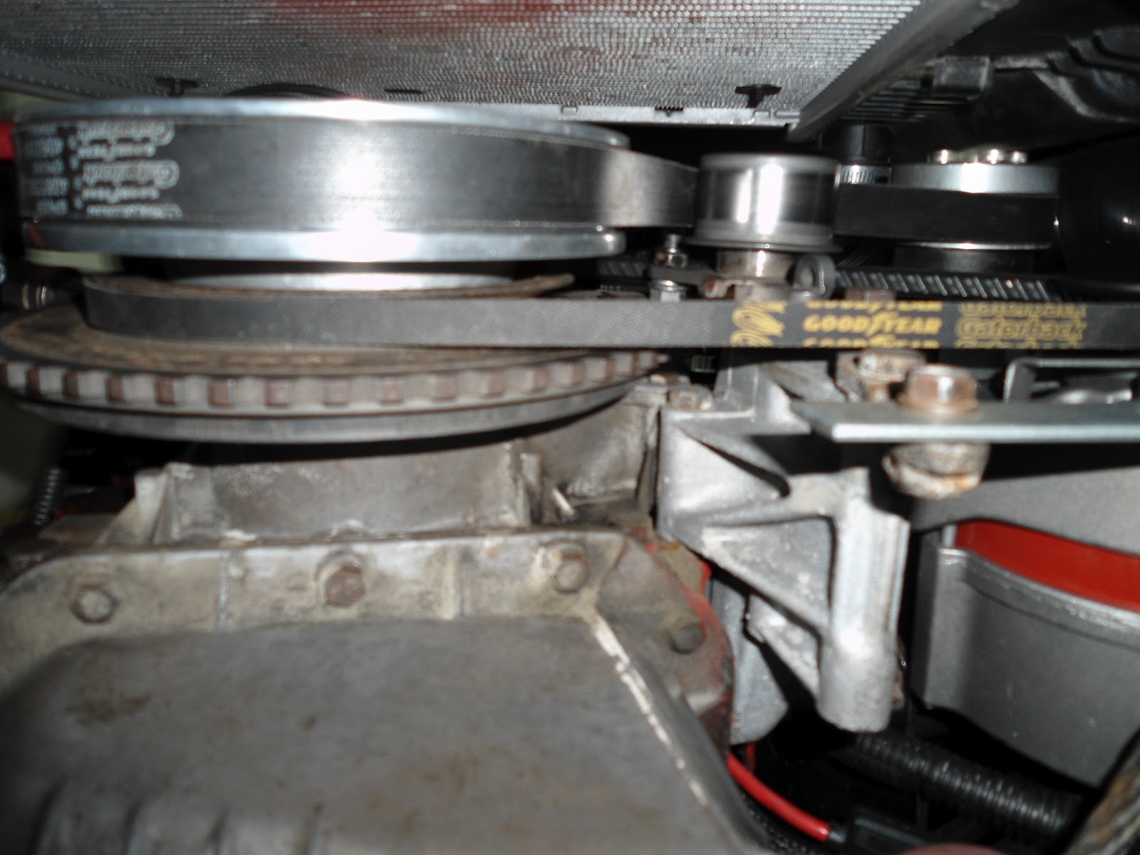

          Long time no update... raison why? Well my PS rack blew as soon as I actived the EPS. What to expect from a 20+ year old PS rack.
          I also installed my new 130A alternator (the old 70A was on its way out anyways) and I needed the extra power for the EPS and new sound system.
          Last but not least I installed my new 7" 6 rib pulley and sourced a nice Good year Gatorback belt for it..took a good 4 different belts to find one and only mod to the tensioner was a reversed install and its nice and tight now making almost 9PSI :)
          Only thing missing now is Tuning...tuning...tuning... and get ready to pass the provincial safety.
