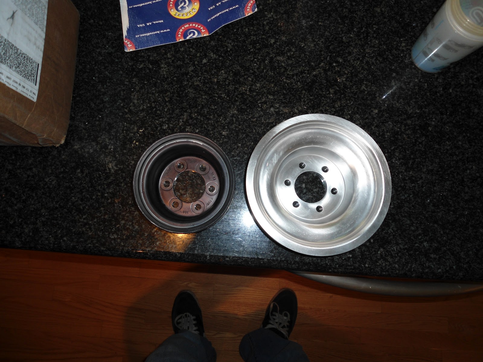

          awesome job! The pulley looks great, how much did that cost? I have local friend supercharging his E30 and in the future he may want a bigger crank pulley made.

            Thanks man. Wasnt easy to find a good tech to built it. My contact is: Mark Campbell at HotRod and Performance: 479-394-5711.
            He did it for 225$. 7" diameter 6 rib. thats a very good price the quality is amazing.

                nope the stock water pump/alternator remains the same size.
                the big crank pulley is ONLY for the supercharger (dedicated belt system with tensioner) so it will only spin the supercharger faster. It will spin it 7"/2.6" = 2.8 times the crank speed I may even have to go with a bigger SC pulley since I bought the quick removal pulley system I will be able to fine tune properly but the limitation is now removed as the m52 crank was only 4.89".

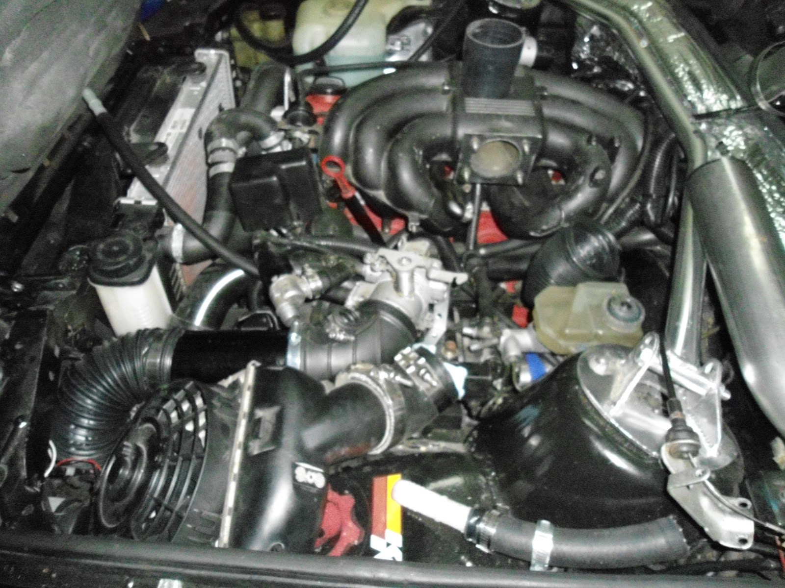

                          -Also relocating my throttle body to make it the way a roots type is really suppose to work (I had issues with drivability and with 10-12 PSI no way a BOV or multiple BOV would work....plus the sound is way too much) so this decrease the sound by a LOT and with no BOV drivability will be much better. Its a lot more work but much worth it.

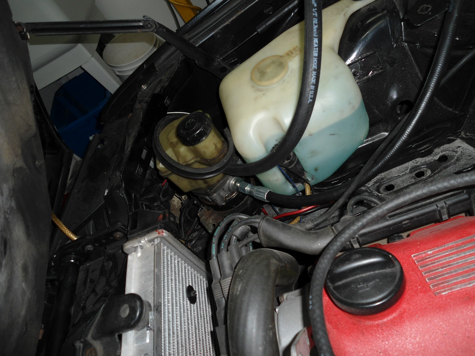

                          And here you can see the location of my electric PS with the high and low pressure attached (just have to make a mount for it)

                              Just finished doing the throttle body relocation world of a difference wow.
                              Tuning idle and part throttle right now...should be on the street soon but I have to retune everything from scratch which is long, this setup (throttle before roots charger) is the way to do it.
