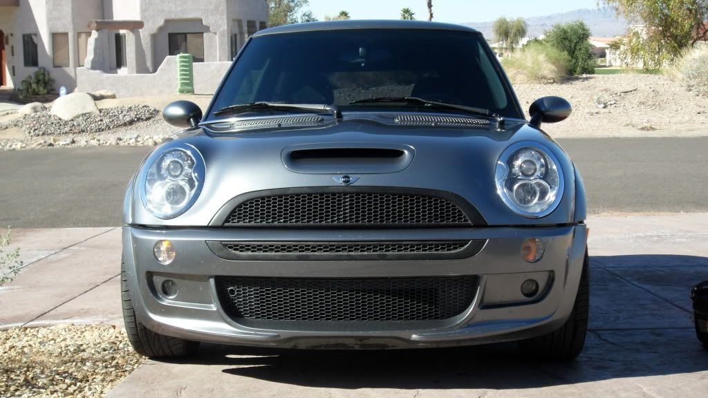

        dat whine. Brings back memories of my dads JCW Mini Cooper.
          Nice Cooper :)
          Actually the wine is not bad... between the M20 valves, exhaust, the wine is just perfect.
