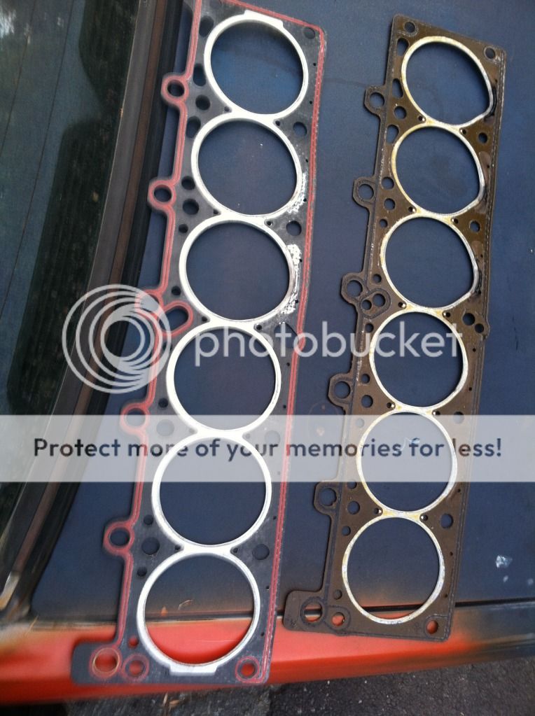

    Here is what I had discovered today.

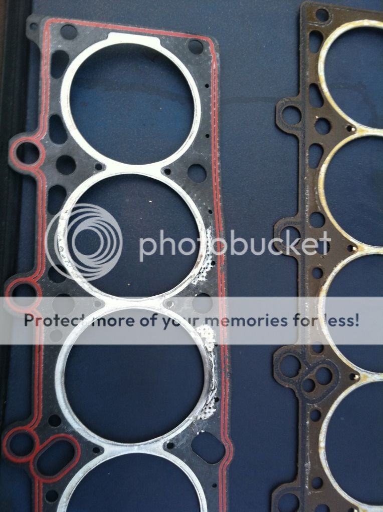

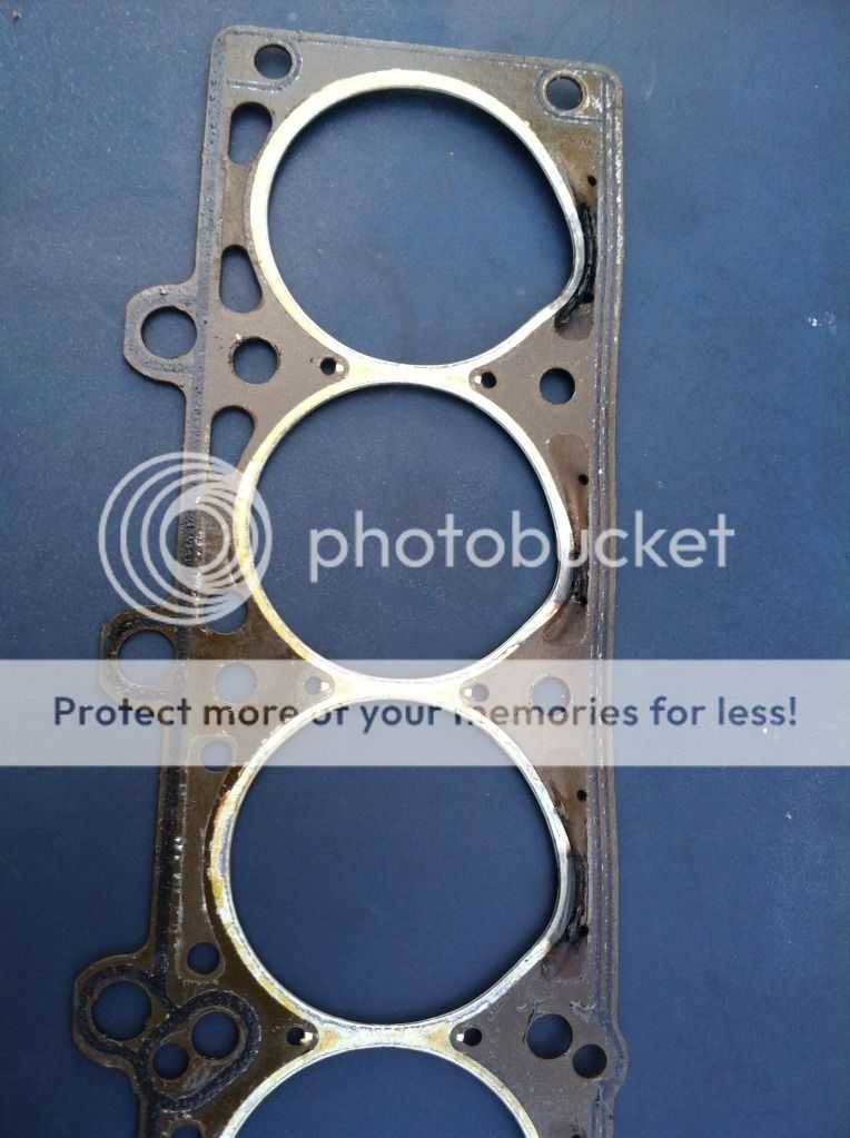

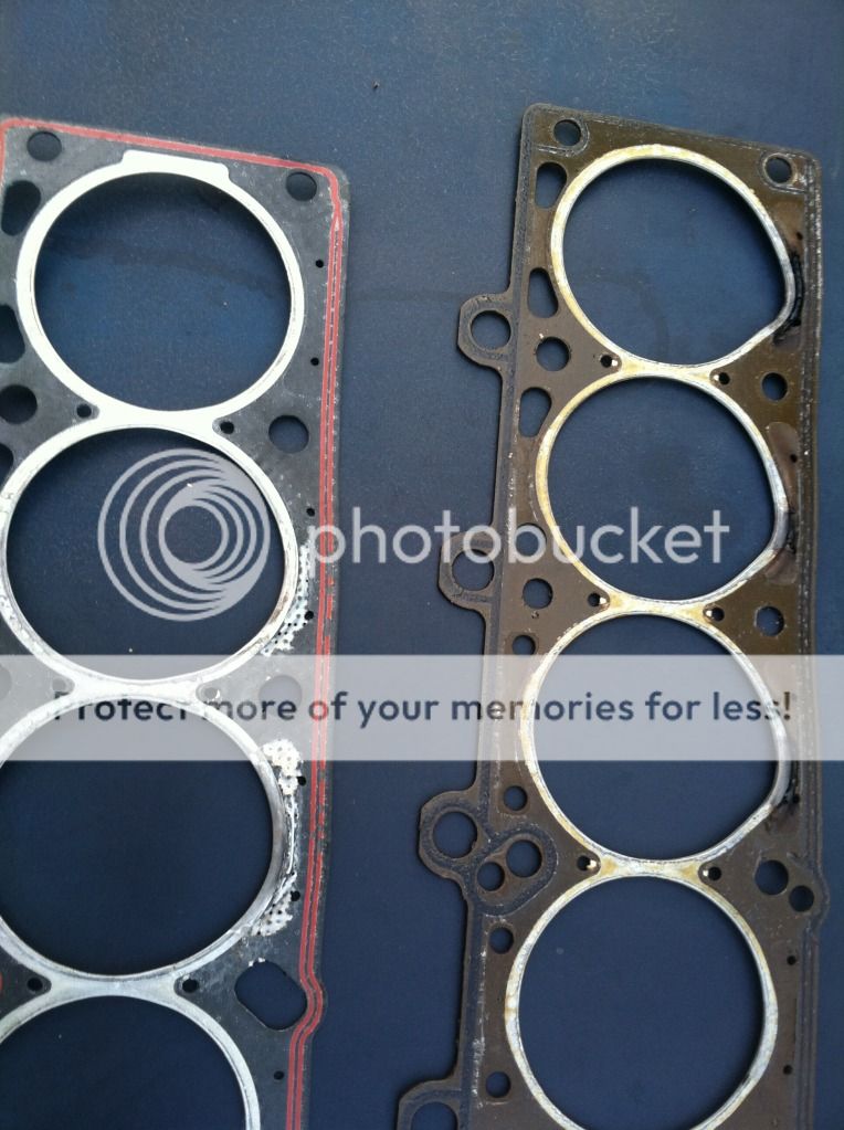

    Left gasket is a klinger gasket which popped the 1st time, and the one on the right is an oem goetze that popped this time. Cylinders on klinger that blew are 4/5 while goetze are 4/5/6
    Klinger
    Goetze
    Under inspection, the block does not seem to have any visible cracks or issues with the copper oringing. The head during first gasket was not used this time, and this head was skimmed and pressure tested. This head does not have any visible cracks.

                          By looking at those gaskets, that thing either had a ton of tkming or the orings arent installed right. With head gaskets like that, the plugs and tops of pistons must be showing signs of detonation
                            And if ur still running the stock iginiton, then you need to check ur base timing
                              After looking at the headgaskets, you are detonating for sure. High cylinder pressure spikes causes the HG to push out like that.

                                Well the plugs are all the tan color, which from what I know is normal combustion. The pistons across the board all looked the same. I talked to a good friend of mine, and yes while a tune would be a cause of it to blow, but its interesting how it blew on 4-5 twice. If there wasn't an issue with the cylinders i would assume the cylinders would all be under the same terms and if one was to detonate it would not always be the same one.
                                On this note, this is the first time the shop oringed a bmw block. I would have to inspect all the orings. Some looked a little flatter then the others, so I am not sure if they ground too deep or what. If the orings are messed up, and the deck surface seems fine, what would be the corrective action? I dont think I could really have the space to rip the engine out and replace the short block, let alone salvage the new bearings and such. Could I just pull out the orings and run it as if it was a normal block?
