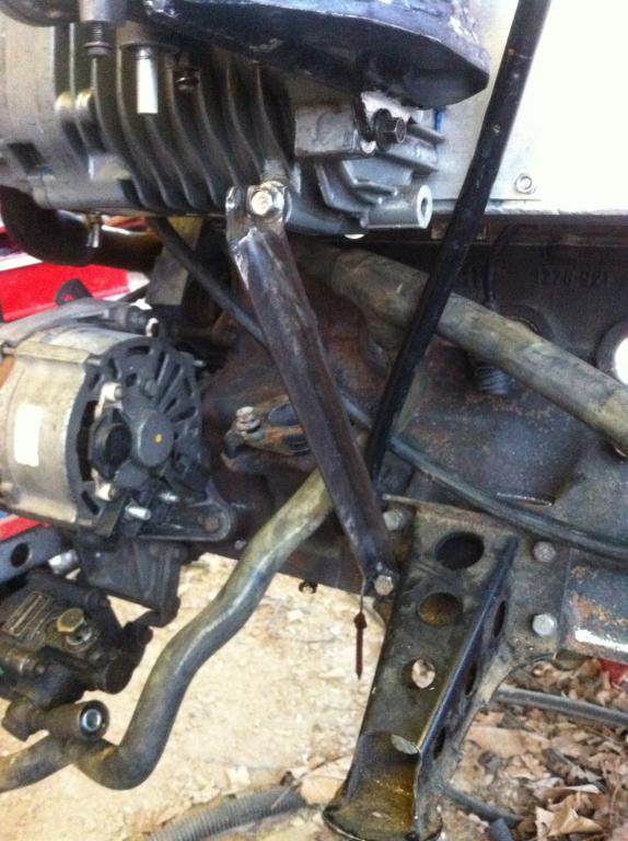

                      I got another support bracket made today. I think this one will alleviate all concerns of the M90 twisting off. It is now very stout.

                          #207
                          Can you make another one for the front end of the blower?
                          After all, that's where the belt loads are being exterted.

                            #208
                            There's just little to work with on the front end.
                            That is where the loads are, but now that the blower is braced top and bottom, and the twisting force is addressed, the leftover force is only tension straight down which, I believe, is pretty much under control.
                            If I can whip up something for the front without getting too tight in there, I'll do it.
