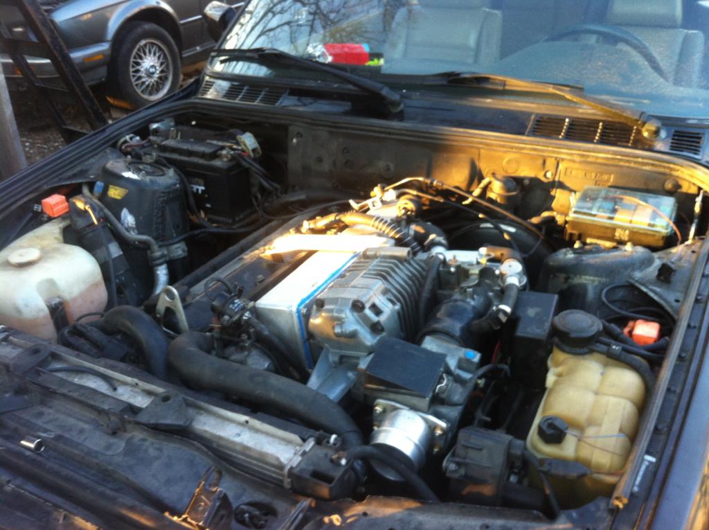

                          Yeah, I've seen pics of a m52 with a cracked valve from a m90, but I think he was running the OE management and thrashing it. I don't want any of that business.
                          But here's this. Sorry, I think I'm in love.
