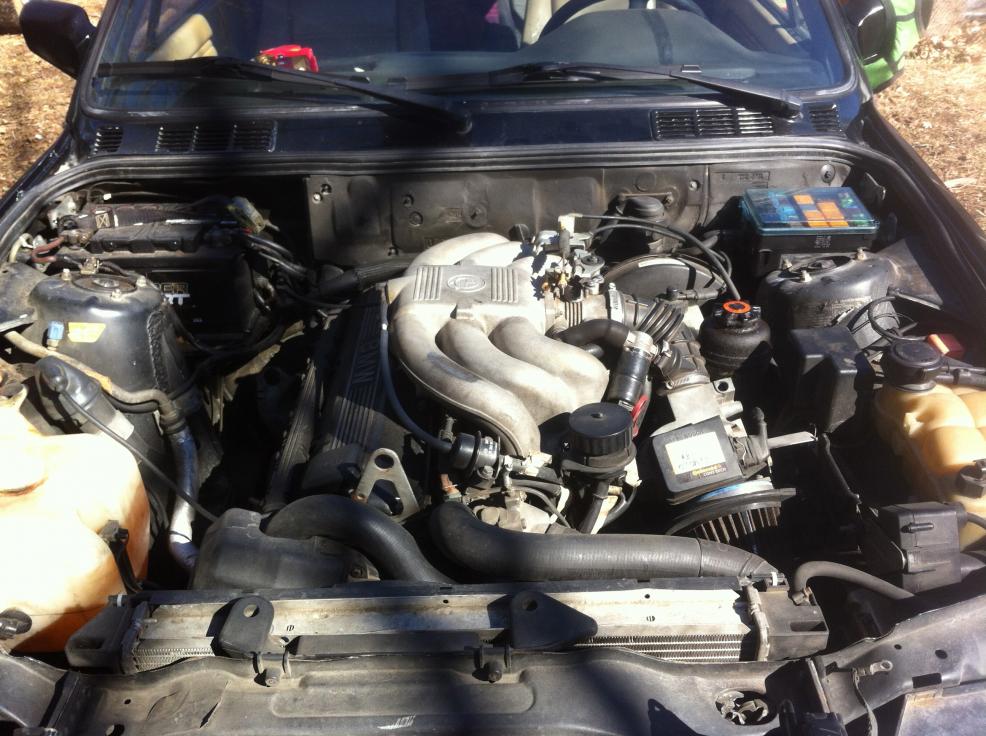

            And second, well I'll just let the pics speak for me...
            Originally posted by Andy.B
            Whenever I am about to make a particularly questionable decision regarding a worryingly cheap diy solution, I just ask myself, "What would Ether-D do?"
            1987 325iS m30b34 Muscle car (Engine electrical phase)
            I was born on 3/25…
            • Ether-D
              • Sep 2011
              • 2838
              #231

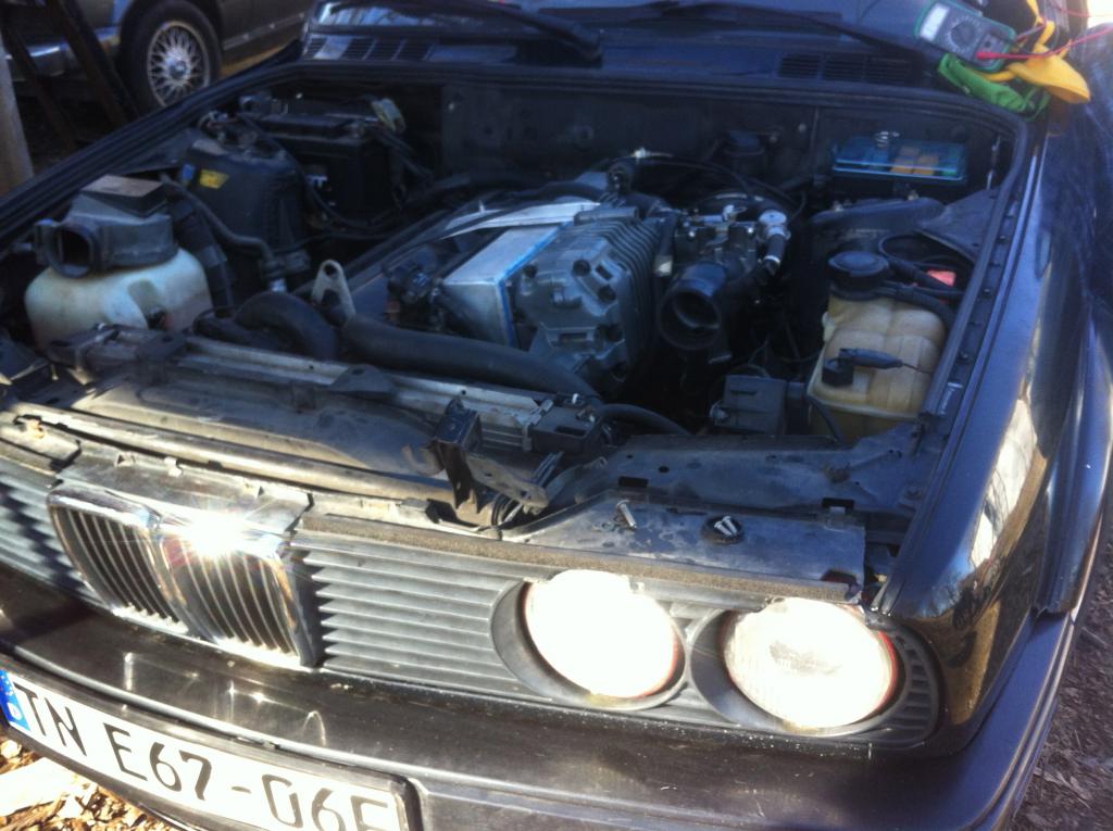

              To this:

                It was a beautiful day here in Middle TN so I got all motivated and decided I was gonna do dis shit. So, from 10:00am til 2:00 I removed and replaced and futzed and dicked. It was on. Then I was all happy and shit cause it started and ran without the belt. And then I realized I was blinded by excitement when I was supposed to install the bitch tube and completely spaced it. Goddammit...
                I was born on 3/25…
                • Ether-D
                  • Sep 2011
                  • 2838
                  #233
                  I also realized that the rubber hose I have connecting the bypass valve doesn't like vacuum all that much and totally sucked in on itself. So I took a long 10 gauge copper wire and wrapped it around a 23mm socket and inserted that into the bypass hose. Works beautifully.
                  So now all I have to do is the whole thing over again. Buttstuff!
