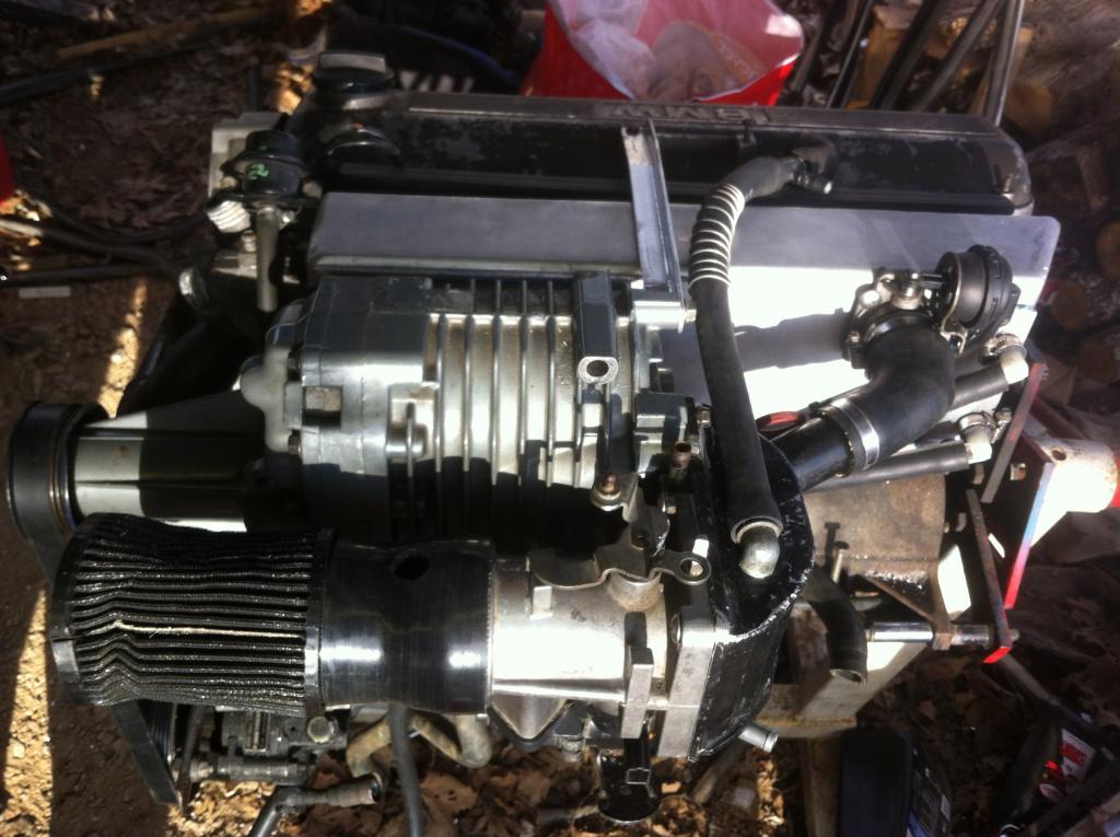

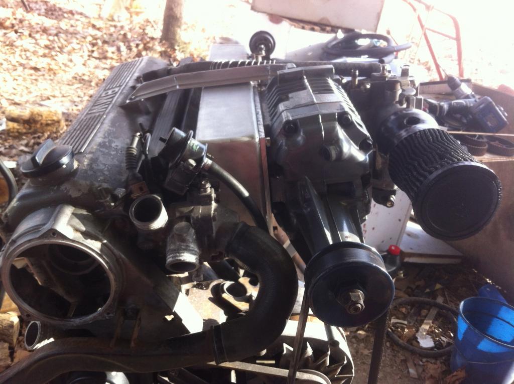

Standing out in the shop just now, I realized that I'm going to have to move the PCV hose to the filter side of the TB to keep the crank case from acting like a giant vacuum reservoir when I release the throttle, causing problems with the brake booster vacuum and the bypass valve vacuum. When I was locating the source for the PCV hose earlier, I couldn't figure out why on the factory TB setup it was on the filter side. Now I know.
I don't think there will be any issue getting the MS2 to listen to the Ford TPS. Just a matter of calibration I think.
On the other hand, I think the Ford idle control is gonna be all screwy. So I'll probably just route around it into the gaping hole I previously made for the PCV hose. Lucky...Last edited by Ether-D; 02-16-2014, 07:37 PM.Originally posted by Andy.BWhenever I am about to make a particularly questionable decision regarding a worryingly cheap diy solution, I just ask myself, "What would Ether-D do?"Comment

Yep, that's the way PCV needs to work... one side to filtered air at atmospheric pressure, one side to manifold vacuum.Standing out in the shop just now, I realized that I'm going to have to move the PCV hose to the filter side of the TB to keep the crank case from acting like a giant vacuum reservoir when I release the throttle, causing problems with the brake booster vacuum and the bypass valve vacuum. When I was locating the source for the PCV hose earlier, I couldn't figure out why on the factory TB setup it was on the filter side. Now I know.
The atmospheric side of the PCV should be *AFTER* the MAF/AFM, however. That air goes through the crank case and ends up being burned in the engine, so it needs to be metered.Comment
