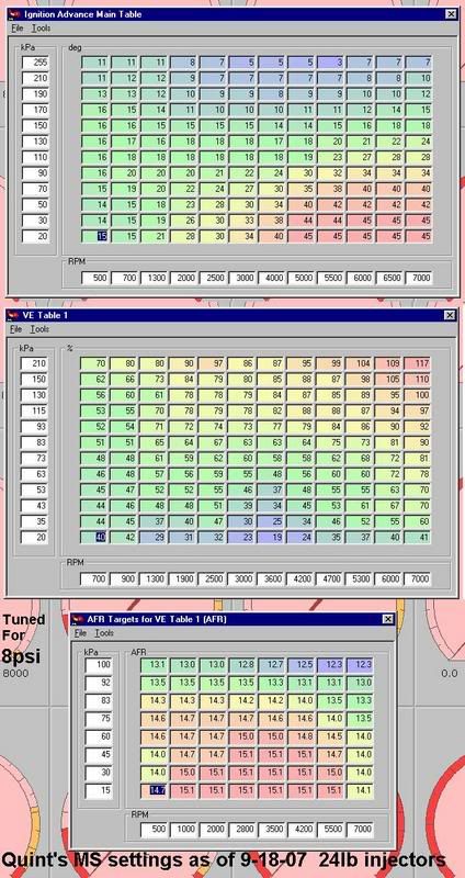

              If it pings pull back timing in those spark bins. If it is too rich (why do you need 10:1 at idle? Does it idle better? I feel like my old beast used to idle best a little lean... at 15:1 or so?
              Do a logged drive and autotune to the afr table you set keeping it rich 12:1 or so while in the power areas for safety. If you feel 'ping' or are scared pull timing back from the timing map.
              Not sure what idle sensor you are using but the tuning instructions for both are here: http://www.megamanual.com/ms2/tune.htm
              Changing from 33 to 36lbers should literally mean dropping your req fuel value to down like 8% or so. A single value in MS changes this.
              Currently your fuel map would be 8% rich if it was tuned for 33s and you put in 36s, but your afr map that megasquirt uses to adjust the fueling would pull it down to the values you put in that table, EXCEPT for areas under that map (usually 2000rpm ie idle). That is why your idle is so rich and everything else that started 8% rich just tuned itself back to exactly what you had in your afr map.
              You can leave the req fuel the same and just tune down your idle fuel map, or restart with the same 33lb map and tune down the req fuel 8% (what I would advise).
              Edit: how does your spark map compare to other turbo/supercharged spark maps? Is it an aggressive max hp on 93 octane dyno tuned spark map? A de-tuned street version of that map?Knowing where that came from is kind of critical. Also because I want to compare the one I have heh.
              This was my old turbo tune from ms1extra. It is a de-tuned version of somebodys turbo map from e30tech many moons ago. It could probably go up 5-10deg in some areas but I wanted to be 'super safe' as it was a street tune that was already shredding a stock clutch.

                So the tune is mostly Whodwho's base tune that comes with the whodwho ms2. I've adjusted the idle pwm somethingerothers to get the idle down and told it that I have 34# injectors and that's about it. I've driven it about 2 miles. I've stepped on it a few times and the AFRs stay real good when getting on it. I didn't hear any pinging this time.
                  Why do you advise that? While it's possible to tell the computer that he's running pretty much any injector flow rate and tune around it in the VE tables, why bother? Put the right injector flow rate in and then you don't have to remember later what you lied to the computer about.
