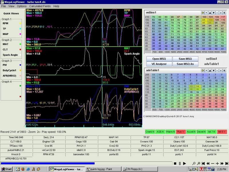

                        Here is a log of 24lbers at 82% at 150 map (about 7 or 8psi at just 4700rpm)
                        If you already have megasquirt there is literally no reason to not run 42lbers, other than trying to save $75 bucks. The thing about running out of fuel, or having an injector stick open, is that the result is usually worse than $75$ of trouble.
