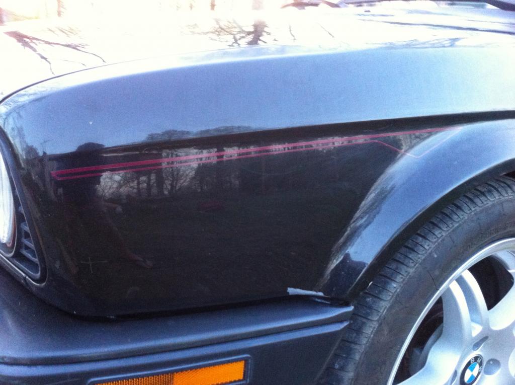

                            I got off my ass and put the 3.73 lsd back in today. I was kinda nervous about it. I was afraid it would lose all the big balls. It's just fine. It seemed to sustain more boost. I saw it go over 7psi (barely) for the first time ever. I reckon I might even get back some MPGs. I got 20 mpg last tank.
                            Also re-did my pin stripes in an A/C Schnitzer sort of tribute in burgundy. I think it's titties.

                              take your top off.
                              Show me them pin stripes.
                              Now I am trying to figure out some crazy tensioner situation, but I should have like 50%+ wrap without it. I went with the custom pulley but added in a vgrove for the ps, but in doing so had to delete the stock mechanical fan because of it pushing it all forward.
                                A/C Schnitzer inspired pin stripe.
