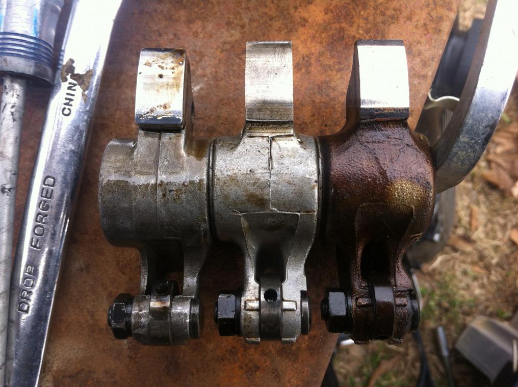

                            So I replaced all 12 of my rockers today. There is a reason. They were all some kind of aftermarket rockers that I took off of a very fresh AMC head that I got at the pull a part. Long story short, the new AMC head was murdered by the installer. He used a sledge hammer to beat the rocker shafts in to submission. Irrrrrrregardless, I used the nice brand new rockers on the head that I rebuilt for the yard motor. Then I broke this one last week and I decided to do a comparison of the ones I have. So, here's a pic for posterity. Does anyone want to guess which type I broke?

                              One of them is OE bmw, one is the redesign by Febi, and one is an aftermarket piece of dog shit.

                                I'm going to say the dog shit is on the left.
