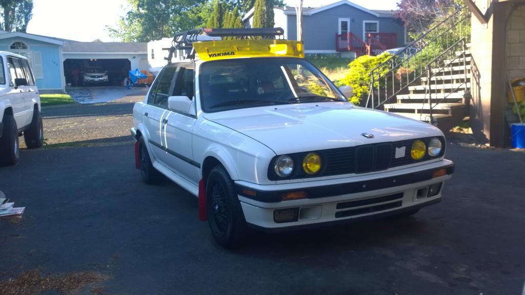

    A couple days before the surgery lol

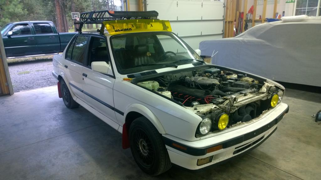

    Pulled In with hood off

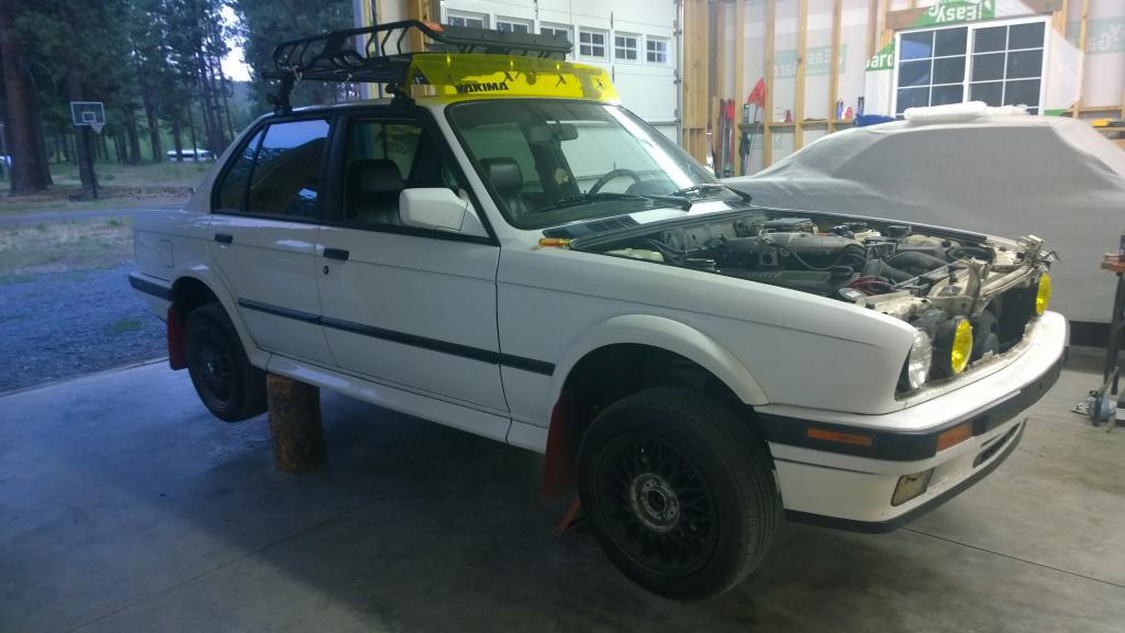

    On jack stands and three rounds I know its sketchy but its all I have 2 on pinch welds and 1 under rear diff.

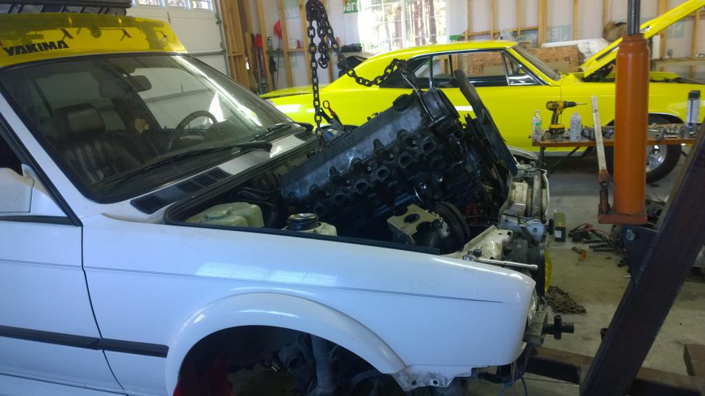

    And fast forward to heart surgery

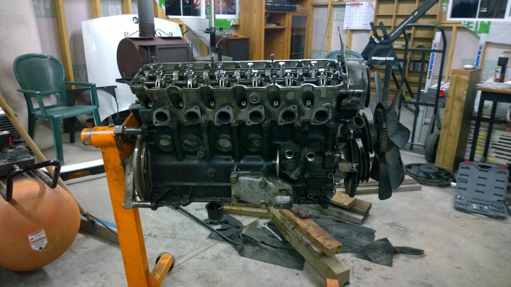

    I pulled the trans and engine together was a lot easier, got the engine on a stand and will be pulling it apart to take to the machine shop.
