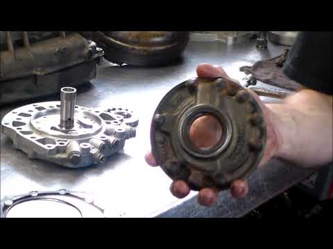

    Hey R3V-
    I have been digging through the archives and coming up blank.
    Back when I had my first iX, a metal round “seal” on the input shaft of the 4hp22 failed and leaked fluid into the clutch packs and knocked them out, leaving me with only reverse.
    If I remember correctly, this is an extremely common issue on the 4hp22.
    Does anyone know/remember the p/n or exact name of that seal? I can’t seem to find it, even on realOEM.
    I have been selling several auto transmissions lately and would like to replace it on these ones that I am selling for the next guys.
    Thanks-

    I believe those seals are replaced by teflon ones.
    http://bmwe32.masscom.net/moswald/zf...2_rebuild.html

      You sir are a saint- many thanks. This was exactly the info I was after.
