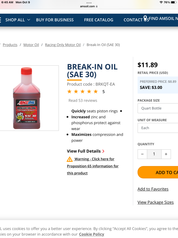

                  I use Amzoil break oil pictured below. Once break in is over Castrol 20/50 with Rislone ZDDP additive.
                  Click image for larger version  Name:	7D53D095-C705-47F0-A0E5-7735F0B15303.png Views:	0 Size:	140.2 KB ID:	10105401
                    i was looking for a break in oil locally and have come up completely empty. local advice has been to just use a regular oil with higher zddp. simply trying to find a regular oil with higher levels of zddp is a teeth grinding proposition. what i've found is a pandoras box of contradicting info.
