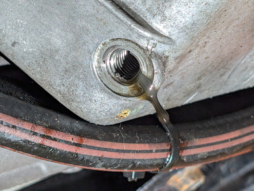

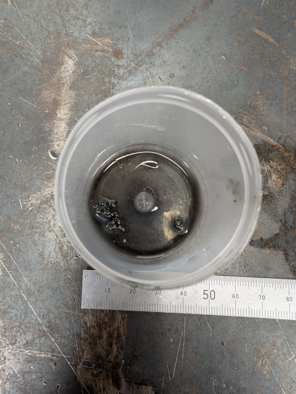

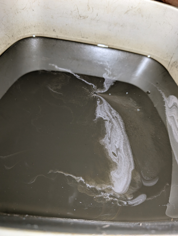

    Drained the oil out of my M20B25, found metal debris on the plug magnet. The oil is dark grey. It was running fine. Has been turboed for about 5 years, but not done many miles. Don't know the mileage or previous use of the engine. The block is untouched by me. Previous oil changes have always had clean looking oil.
    Am I right in saying there's no point taking the sump off to have a look (given it's awkward with the engine in place), and it's going to require a full strip down? What is likely to have failed?

    i'm guessing rings. top is probably good. looks like a bottom rebuild at any rate. it won't matter if it's only rings, it all gets done when opening the bottom.

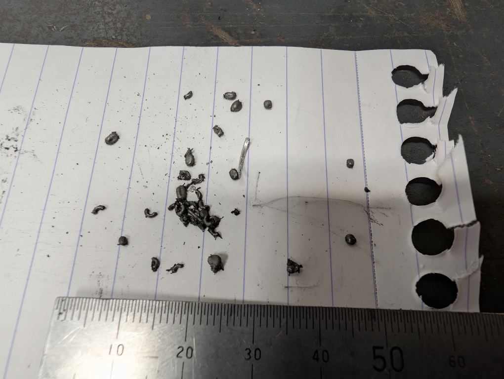

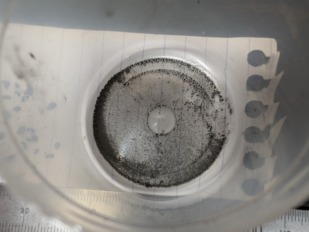

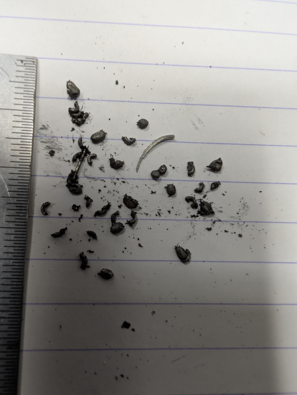

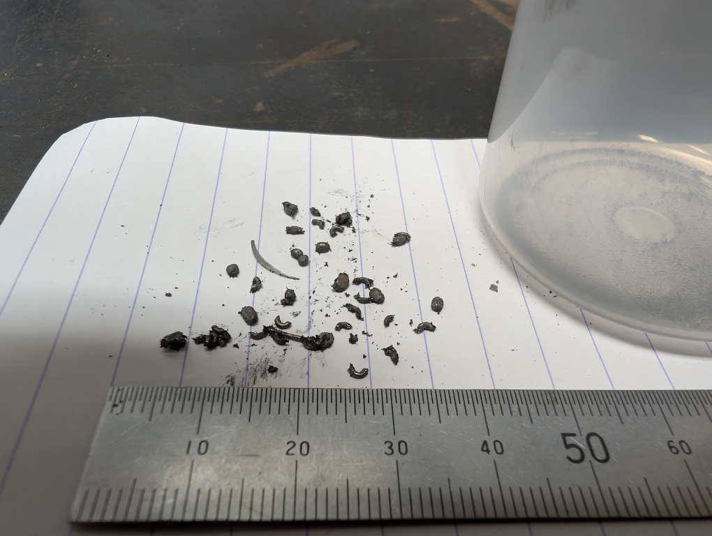

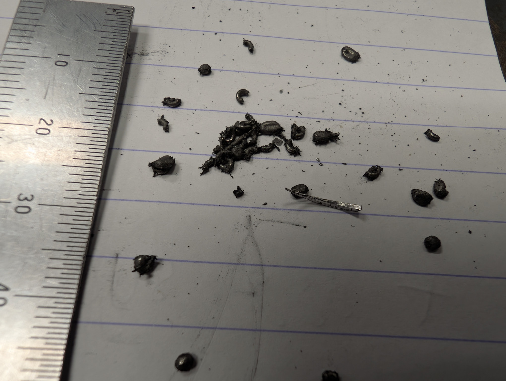

        Not had a chance to look any further, got some close up of the debris though. There may have been some knock last time I had it out, don't have detection though just my ears.

        • TobyB
          • Oct 2011
          • 5297
          Those are some odd chunks- off the top of my head, they don't look familiar.
          Like, parts of a small spring and...
          Kind of like something with a small ball bearing is coming apart?
          You don't have a ball- bearing turbo, do you?
          hmmm....

              Those looks like little bits of RTV mostly, except for the silver sliver. You're sure it's all metal?
              Byron
              Leichtbau
              • 14thirty
                • Jul 2021
                • 35
                Definitely all metal, and it's magnetic.

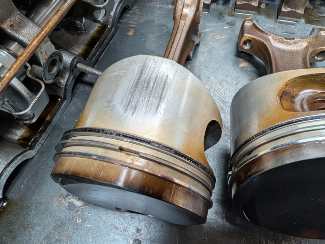

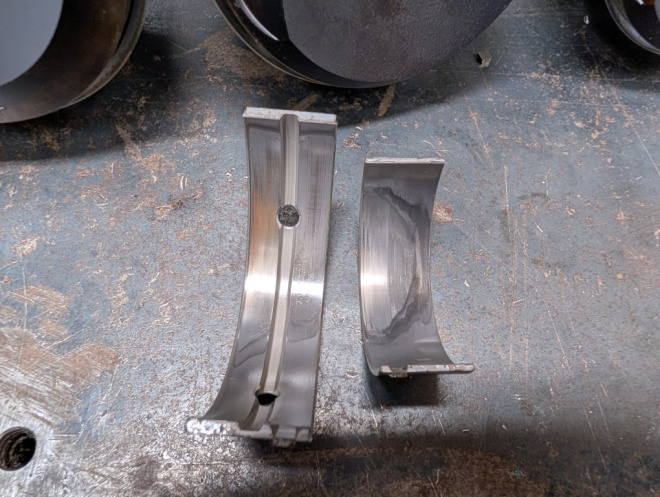

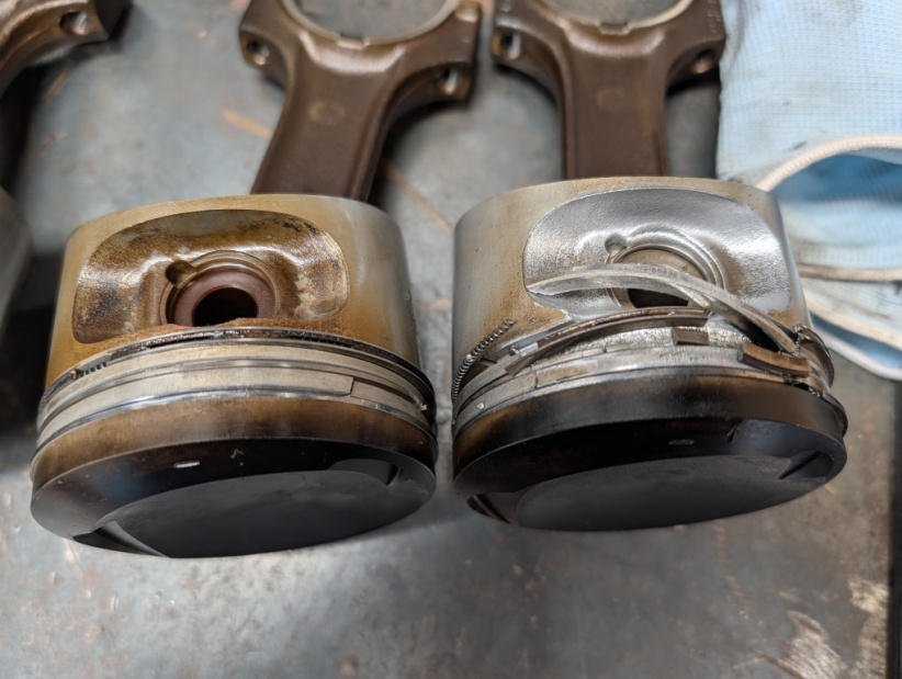

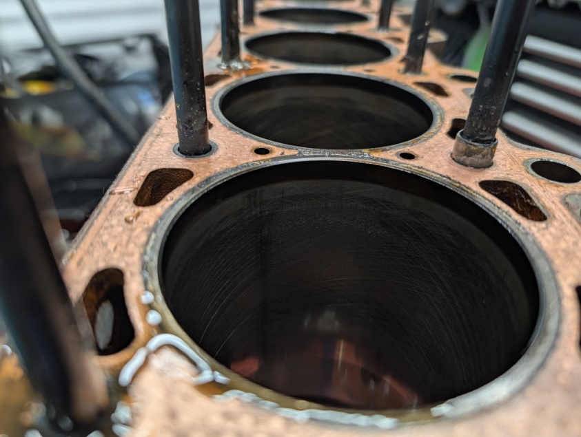

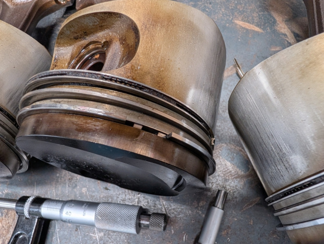

                  Finally got round to looking at this, ringlands on #5 + #6 are broken. #6 is the worst. #4 Has broken the top ring. All the skirts are pretty badly scuffed. There is some damage/wear to the bores. Main and rod bearings are worn.
                  Not sure if this was caused by knock or/and rings not having enough gap. It's the early euro engine with 9.7:1 pistons. Was running about 16psi looking at the last log.

                  • McGyver
                    • 4636
                    Those are fucked. But replacement double over (+0.50mm) pistons are available and cheap! That should be enough to clean up the bores and put it back together in a stock configuration.
