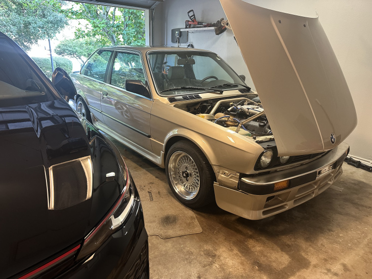

    So I had my new to ‘85 325e running pretty well and handling really well with all new bushings, H&R sports and Koni’s. It was slow as hell with the eta engine but that’s what I knew to expect.
    I had no real plans to build a hot rod but some new developments are pushing me in that direction.
    I did all the expected things that usually need to be done to get these things back on the road…
    Complete fuel system rebuild: Both pumps, filter, all hoses replaced, new FPR, all injectors removed and cleaned and tested. O2 sensor replaced with Bosch replacement.
    Ignition: Cap and rotor;I did cheap out on these, bought Wells Automotive brand that looked pretty good but the cap fitment was awful. New plugs; Initially NGKs but then Bosch, twice. More on that later. New coil, New crank position sensors, also cheap ones, can’t remember the brand but they are still testing within Bentley specs.
    Cylinder head: This was replaced by the previous owner along with the timing belt and water pump in 2023 and the car was never driven because they missed diagnosing a bad CPS.
    I also replaced the clutch master cylinder and slave along with a braided hose and all the bushings in the pedal assembly.
    The car ran well for about 300 miles and all was well, even with the obnoxious straight pipe exhaust. I was actually on my way to the muffler shop to get a muffler when things went south.
    Basiclly this thing has developed a misfire and exhaust backfire at all rpm’s between idle and WOT. It idles a little rough, not too bad and it’ll rev to redline clean but anything in between is awful. Loud backfires and completely un-drivable. This issue is what led me to replace all the ignition components mentioned above. When I briefly had it running, I had only replaced the plugs. Now I’ve replaced the plugs twice more due to gas fouling.
    I’ve tested everything at the DME pin-outs as instructed in the manual an all seems good. The only exception is the AFM. The testing results with anything other than an oscilloscope seems pointless.
    I have done a compression test as well but I don’t have the numbers with me right now. I think they were all around 140 cold.
    Smoke test? Yes I have a smoke tester that works pretty well. The shaft in the throttle body is leaking a bit but no leaks anywhere else after installing all new silicone hoses. I have cleaned, adjusted and tested the TPS..
    So what am I going to do. I’ve got a line on a m20b25 with a Getrag 260 bolted to it out of a ‘90 325i and a 3.73 lsd out of a ‘89 325i. I don’t need the transmission and I’m thinking about just using the 885 head, the Motronic 1.3 stuff and the 325i intake, TB and AFM, all on the stock eta bottom end. I know this low compression set-up isn’t ideal but how bad would it be with the 3.73 diff while I educate myself on turbo’s and stand alone ecu’s?
    I see this thing snowballing but all I really want is a powertrain I can trust on a road trip. Well, I’m not gonna lie, 250hp sounds pretty good too but I still want reliability.
    This forum has already helped me a bunch and I hoping you guys can point me in the right direction with this thing that I’ve really grown to like. I’ve actually been pressured by some friends to engine swap it, one friend owns a classic truck shop that does LS swaps all the time and my neighbor has a shop full of 500-800hp Hondas and he’s in my ear about K swaps but I really dig these M20’s now.
    Look forward to some guidance from the pros here…
