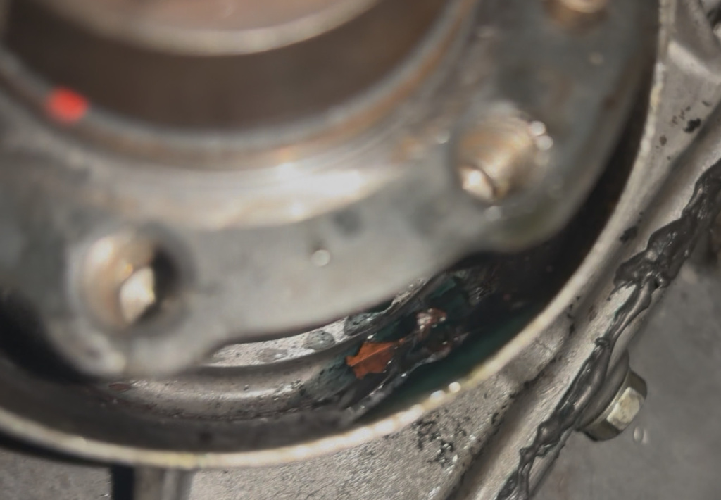

                    Click image for larger version  Name:	IMG_2626.jpg Views:	0 Size:	162.3 KB ID:	10149984
                    Originally posted by digger
                    The initial stumble and then no start is not due to whatever small leak exists at the seal, the engines are not that sensitive to small vacuum leaks
                    you need to treat this a no start scenario and ignore the seal for the moment
                    check for spark, then fuel .....
                    I have confirmed fuel. Was the first thing I checked because it felt like it ran out of gas. Will confirm spark tomorrow AM.
                    I was reviewing the video of the smoke test from when I found the leak. It’s not small. If you ignore the blue fluid (coolant from pulling hose) there’s a chunk of the seal and looks like a chunk of the cover itself. Will disassemble further tomorrow along with spark test.

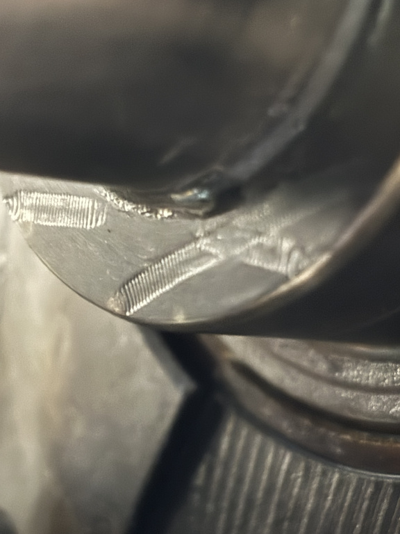

                          Got the front cover and harmonic off. Something went or was bad. The spring/metal inside the seal came out, wrapped around the crank nose, marred the back of the balancer and the nose. If replaced I’m assuming it’ll just go again? Did a video short doing my best to show the nose. Attached is picture of the back of the harmonic. And it was a B to get off because the metal had wrapped into it.
                              https://youtube.com/shorts/03Oprh6nF...nr_TL4Tb4jyWbs
                              how did the front face of that step/shoulder get marred? The crank gear hard bolted to that shoulder
