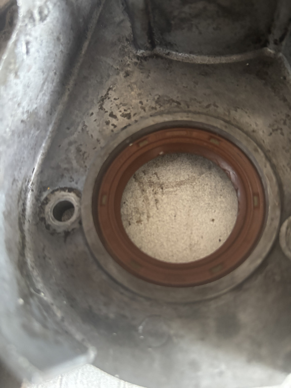

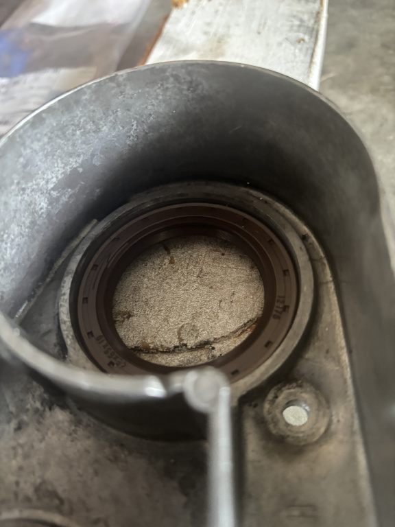

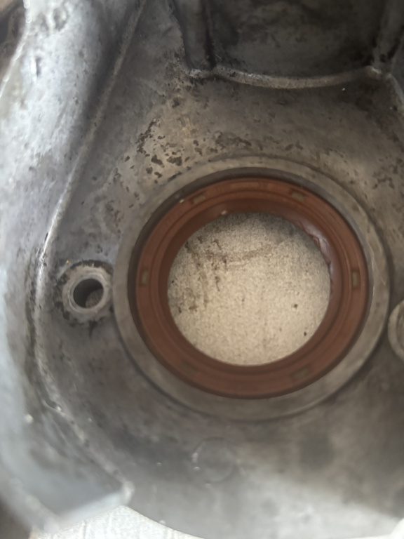

                  Ok. So I’m thinking my issue was I left the front seal for the crank and oil pump more or less flush with the cover. I made a point to seat them a bit deeper. The backs of the seals are basically flush with the back of the cover.
                  If they were flush then the balancer gear and oil pump gear could have grabbed them and caused this failure. Here is how they are seated now. Before installing can I get a thumbs up from the brain trust? Could take more pictures if it'll help. Did not install yet.
                  Click image for larger version  Name:	IMG_2697.jpg Views:	0 Size:	114.7 KB ID:	10150569 Click image for larger version  Name:	IMG_2696.jpg Views:	0 Size:	127.6 KB ID:	10150568
                  • digger
                    • Nov 2005
                    • 6207
                    its probably the photo/light reflection (as they normal have a texture to them) but the edge of the lighter seal look uneven/non uniform. Yes you do need to make sure it is as a minimum perfectly flush as there at most 0.040" from the back of the gear to the front edge of the housing but going slightly deeper will sit on fresh metal so preferred on a well used engine
                    • JerEazy
                      • Jun 2025
                      • 35
                      Ok - they are deeper - the back of them is flush with the back of the housing. I could push them back the other way a bit. And yes, that’s a lighting/angle issue on the oil pump seal. It is uniform and not torn or beat.
