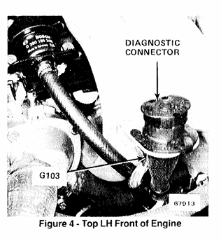

        pretty sure the ecu grounds back to the g103.

                I’m pretty sure this ground is missing. I need to find a picture lol

                  This is from the 87 325e ETM. Looks like the ground is on the intake manifold. Perhaps it's where the diagnostic bracket mounts.
                  Click image for larger version  Name:	image.png Views:	0 Size:	109.0 KB ID:	10160500

                    is there a ground point on the passenger shock tower?
                    it would help if you had an etm for the e car. i am not sure where there is one any longer. we lost all the resources for it i knew of.
