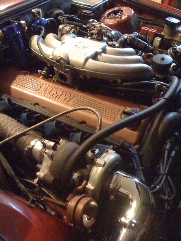

      Megasquirt, T3/4, and some money thrown in for good measure I had this
      At the beginning of 2011 our cars were looking good, and performing good. One turbo e30, one 2.5L NA e30.

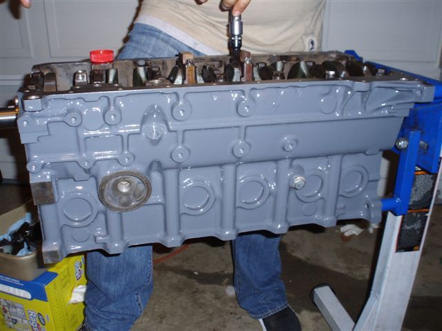

                Its been a bit, but here are some updates.

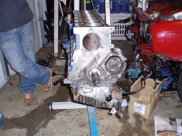

                I got my block back from the machine shop. I had it hot-tanked, honed, and all the specs checked. It came back perfect. A coat of paint, and its ready for assembly.

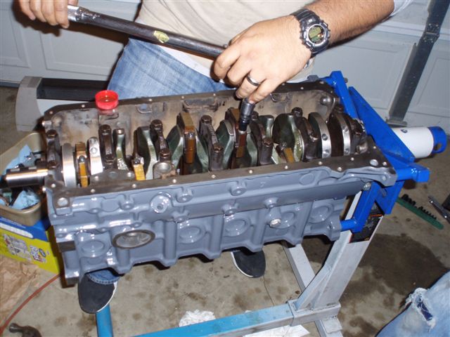

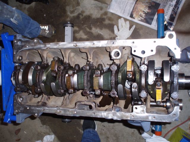

                Crank was put in dry, and all the main bearings were torqued and plastigauged to check tolerances. A few of the bearings were moved around to get the clearances as even as possible across the main bearing journals.
Name:	crank torquing.JPG
                Once that was done, the same thing was done with the Pistons and Rod journals. A few bearings were moved around after clearances were initially check to have even tolerances across the face of the crankshaft.
Name:	crank completed.JPG

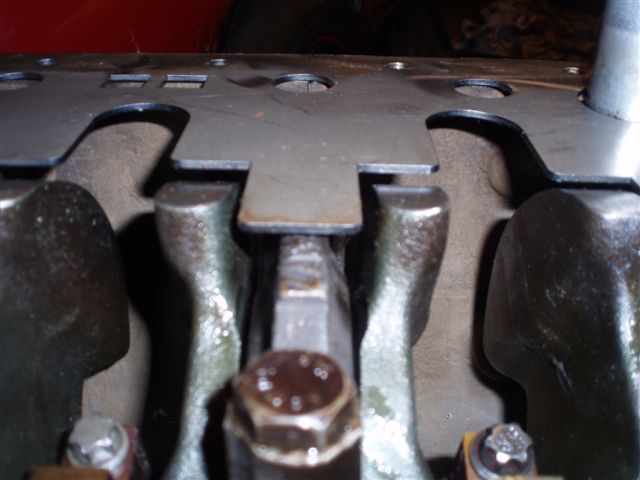

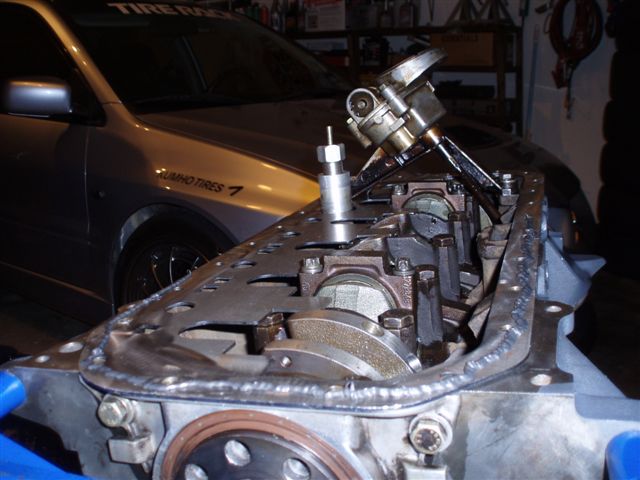

                After the bottom end was in place, and all the seals put back in, we started putting the crank scraper and oil pump in place.
Name:	close crank scraper.JPG
                So that completed the bottom end.
Name:	bottom end complete.JPG

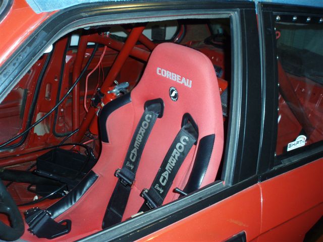

                  drivers seat and interior cage shot, with all the battery wiring being redone, its a mess right now

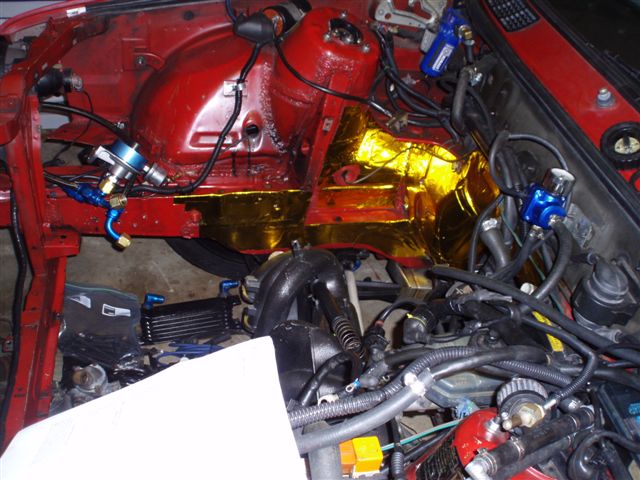

                  this is the engine bay, that is housing all the peripherals right now....soon it will house the motor
                  here is another shot of the crankscraper installed
Name:	side crank scraper.JPG
