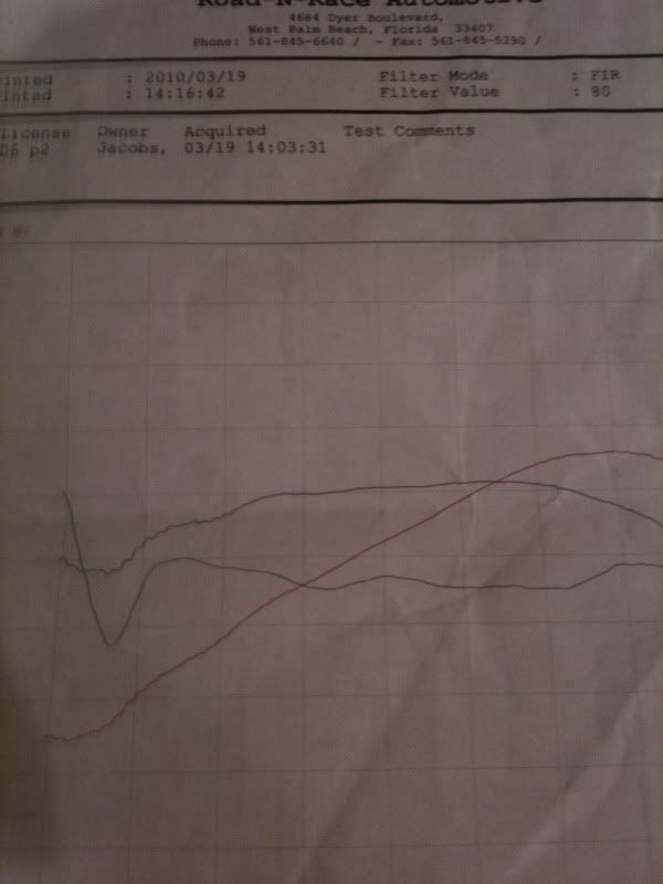

                              • briansjacobs
                                • 1278
                                not showing any numbers on purpose, I just wanted to show the sexy curves we are making. on later runs we got the AFR flat and numbers got a little better but I never printed that sheet out. For the most part I dont have a need to rev past 6k because the torque is more usefull than the HP
                                Brian Jacobs
