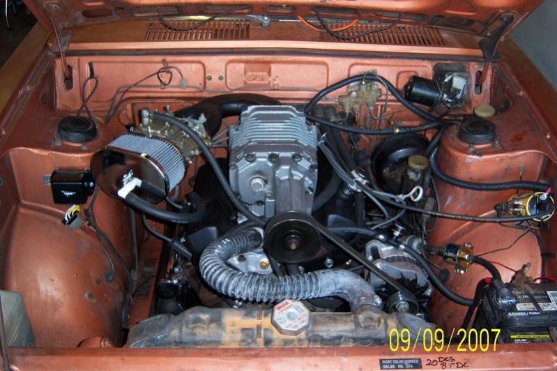

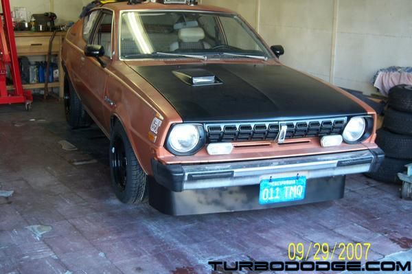

        Do you remeber this thing....;)
Name:	J's pic's 099.jpg

            Ah, blownarrow lol. Now I do ;) I have the same 2 usernames (also Forced_Fireird) on all the forums :D Google them sometime...
