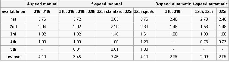

                          I don't think that fluid will have anything to do with it, though changing it is always good. Think about it, a differential is either engaged or it isn't. Fluid or lack of fluid doesn't play a part in RPMs. I honestly think there isn't a problem. It sounds like you have a 4.10 diff with a 3.73 cover. What year and model E30 do you have.
                          Here are the gear ratios for different models (SEE ATTACHMENT)
                          Heres a calculator that will tell you RPM. Just input the data for your model and BAM! You're pregnant. I mean, your RPM.
                          http://www.f-body.org/gears/
                          I put in the numbers for a 325i 5 speed w/ a 4.10 and got 60mph @ 3100rpm just as nando says.
                          Post what transmission you have and we can help you.
                          Also post which differential you had before and RPM at speed with that diff.
