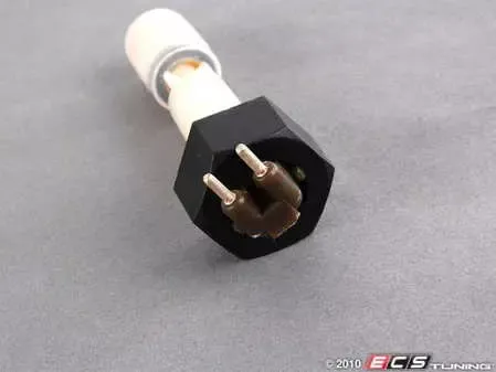

    On my 87 325e the connector's clip that hooks to the coolant sensor is busted and will come loose triggering the coolant check light. What is the part number or where can I get a replacement connector?

              OP? Its the coolant level sensor

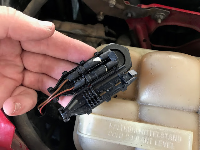

                I need to revive this old thread since I can't find any information about the coolant LEVEL sensor connector. What is posted above is for the coolant temp sensor, but OP was asking for the LEVEL sensor connector, as am I since mine fell off and burnt up on my exhaust header. As fast as I know, the check light can only come on when the level is low. This is the relevant sensor for which I'm trying to find the connector.

                  I recently replaced the connectors on two cars. Here's what I've gathered...you can get the new longer housing for a few bucks but the waterproof female terminals with wiring that fit the connector are NLA. Luckily, I was able to salvage these female terminals from other connectors I had laying around. Of course, you could also just cut the connector off a parts car but it will likely also be 30+ years old and ready to crumble. I cut a few of them off of parts cars over the years realizing they often break. I wished I had taken more when E30's were plentiful at the yards. I believe the later models also use the same terminals for the brake fluid level sensor. The coolant res and brake fluid res are on the intake side on late models so they are subjected to less direct heat than the early models.

                      A newer connector plastic is the part # 61131378408. It's a little bit longer than the original. Some people cut it.
                      A repair terminal is also available.
