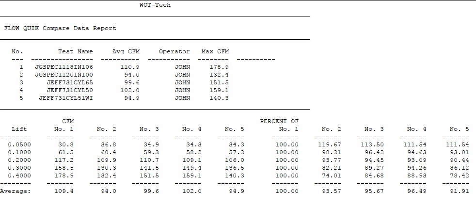

                                I was able to recover the database!
                                Test 1: Stock 885
                                Test 2: AMC
                                Test 3: 731 port #6 with 885 valves? (didn't measure) DIY porting
                                Test 4: same except port #5
                                Test 5: 731 port #5 repeated with 323 DIY ported manifold, "i" TB pinned open (note: plenum not bored to match TB)
