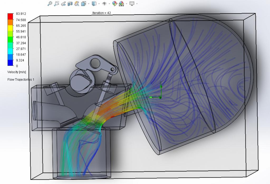

      I got 22deg as well. I have the head reverse engineered to the best of my caliper measuring ability, put a degree finder/ dial indicator on the cam and got a rough profile. Pipemax gives me a target duration at .050" of cam lift, so I was/ still am kind of in the dark as to what that equates to in valve lift. Rocker ratio's are still perplexing me, CAT cams specs show 1.61:1 at max lift, but my measurements on the stock cam/ valve arrangement put me closer to 1.45:1, and my model gives me 1.55:1 ratio.. I pretty much concluded this was all a huge waste of time, and I'll just go with the cam that has the highest lift with least amount of duration.
      My computer isn't fast enough to get the mesh settings I'd like so the flow numbers are meaningless, looks cool though.

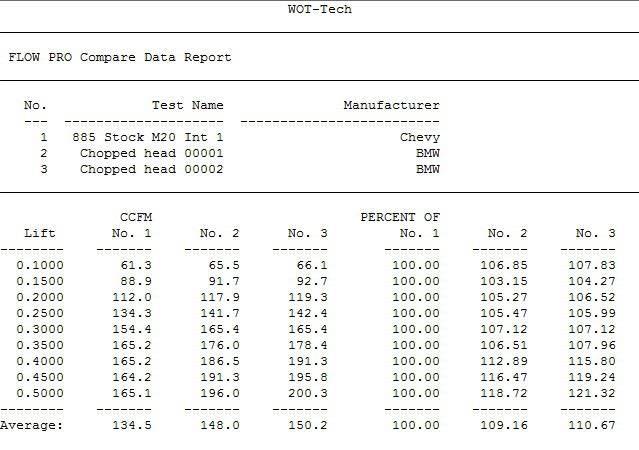

                Found some more on the intake using a stock valve. Ignore the name of the head, got sick of lugging and bolting full heads on the bench, so chopped one up into single cylinders for research purposes. ~185-ish at .400 has been pretty consistent with the valve angles I've been using, tried something new and got another 5cfm. The first test is a random selected stock port for the database. The second two tests were done back-to-back with the additional found angle (that actually helps).
                When time permits, will test the same port with a Supertech valve with the 6mm stem, as well as a standard +1mm valve, then again with the Supertech +1. As mentioned earlier in the thread, simply cutting the seats for a larger valve hurts flow, the angles have to change for larger valves to work proper.
                Click image for larger version  Name:	stock valve flow.jpg Views:	0 Size:	67.3 KB ID:	9963182
                Originally posted by decay
                i saw that, which is what made me ask the question- 885 valves in a 731 head is where i'm likely to wind up- do you have a baseline on an unmodified 731?
                731 mods will be soon. The 885 valves are a little large for the 731 seats, so have a plan for that. Member here ordered a modified 731 head. :)

                  +1mm valve, mild porting, 3 angle valve job. Pretty sure there's more still in there (again random stock port drawn from the database)....

                    thats starting to get very good that cracked one you gave me went 200@400 and 216@ 500 +2mm different bench of course so they are probably as transferrable as the ole dyno. Amazing how little material needs to be removed.

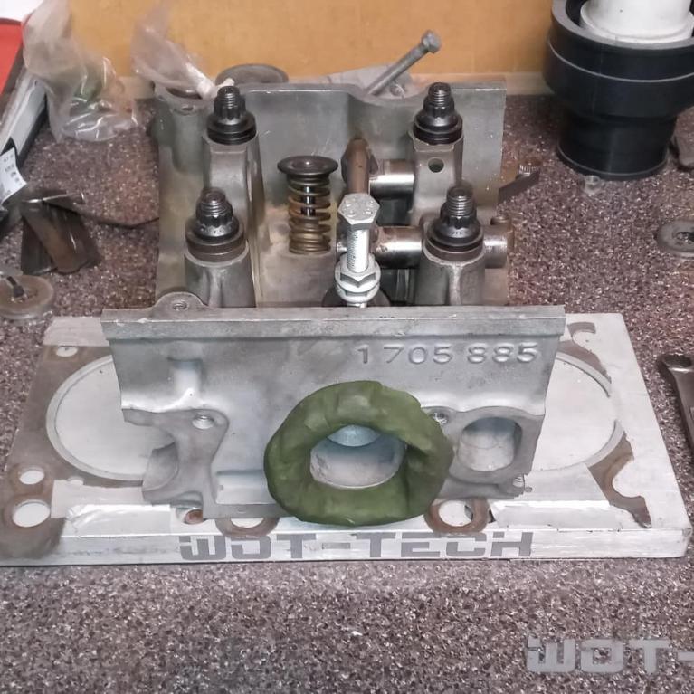

                      Yeah, well, typically clients like me to be all hush-hush, but don't think this guys cares....
                      up-cycling cracked m20 heads :)
                      Yes, very little material, and because of that, doesn't take much to botch it, either.
                      ...and yeah, benches are like dynos, but these Flow Quik benches seem to be very close to SuperFlow and the pass around plates help get your calibration spot on. Have though about adding additional pitot tubes etc to get analog readings to verify, but as long as the FQ is calibrated often, it's been working just fine.
