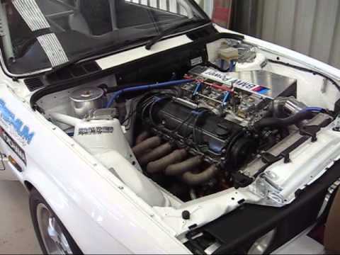

                  x2. I've got one customer in Switzerland who's right there.
                  Here's some more (though not the swiss gentleman).
