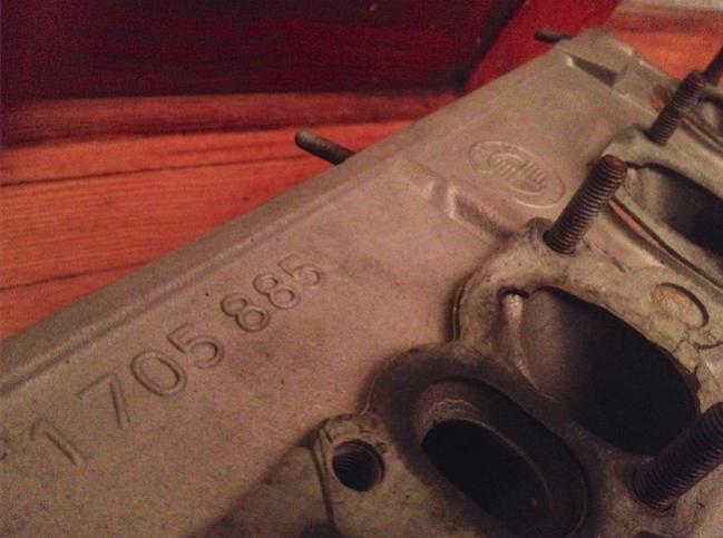

                  • fiveightandten
                    • Nov 2013
                    • 257
                    #39
                    If anyone has any parts that would help me piece together a 2.7i setup, hit me up.
                    I'm off to a good start with today's pickup...
                    -Nick
                    1986 325es || 1998 M3 sedan || 2003 330ci
                    ~Looking for a left side early tail light, or a set of early tails~
