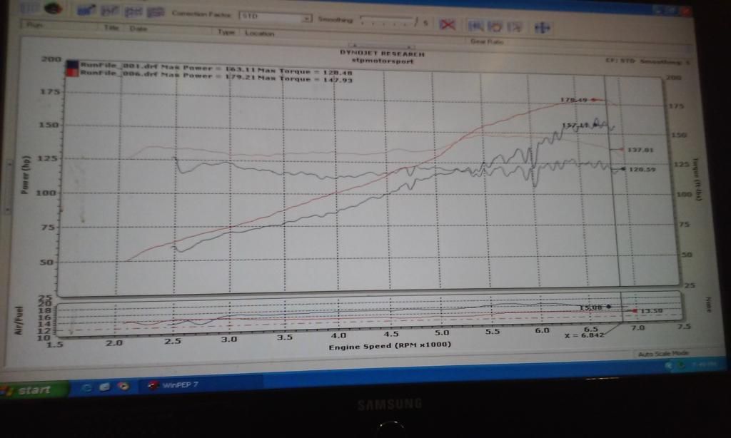

        Just dyno'd a set of Extrudabody 45mm ITB's on an m20 yesterday, and a couple months ago did the RHD set. Both cars were high mile stock 2.5's with a rebuilt head and 272 cam - both cars were within a couple HP of each other, the RHD car has headers, dual exhaust with x-pipe, twin resonators, light porting, larger valves and flow tested. Extrudabody car has a full stock exhaust.
        RHD dyno:
        Extrudabody dyno:

          yes, much the same peak hp but the RHD smashes the Exrudeabody in the midrange as you would expect, obviously other differences exist but the boring flat torque and lack of hump in the midrange will more than likely be the ITB, they just dont "tune" where they are supposed to as they are mismatched to the engine combo
          Rpm / tq RHD / tq EXT
          2500rpm / 135 / 135
          3000rpm / 143 / 130
          3500rpm /145 / 132
          4000rpm / 150 / 133
          4500rpm / 160 / 135
          5000rpm / 158/ 135
          5500rpm / 162 / 145
          6000rpm /152 /145
          At 4500rpm the RHD has 25 ft-lb advantage which is 18.5%
          shame its not a direct comparison on the same engine etc but sometimes that is a rare luxury, nevertheless great info
          it would appear that atleast with extrudabody you get a topend gain unlike dbilas, this is likely due to better manifold (rowlands >> dbilas)
