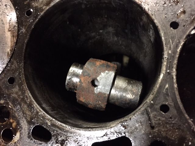

    Thought my problem was just a blown head gasket, but found a little more than that. Classic example of continuing to drive after over heating. Over cooked engines have a unique smell once you open them up, never smelled anything like this on a car before.
    Oh well, that's what I get for buying a non-running $800 car site unseen. Now need to decide if this will be a parts car or not. Definitely can make my money back selling parts but the body's in great shape so will probably spend some time trying to find a running engine before parting.

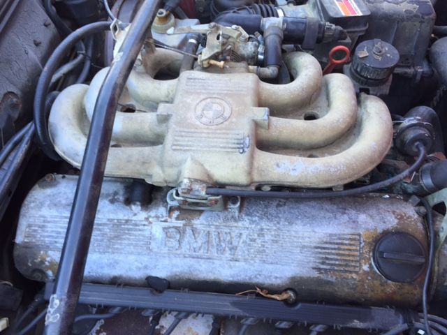

                        Today I bought a 1988 325 with a running super eta engine for $650 so I will be using the bottom end from this car to build a 2.7I engine to put back in the 325is.

                          An 88 super eta is already a 2.7i. Pretty sweet score for 650$. Post pics of the cars already.

                            Yeah, the car is kind of a piece of crap but it has the super eta motor. I know it's a 2.7 motor but I'm going to do the full i top end swap with the head, intake, etc off a 325i. Extra bonus is that the 325 is a manual and the 325is I'm putting the motor in is an auto so I'll be doing the auto manual swap also.

                              If its a 1988 Super eta it already is a "2.7i". It already has a 2.5 top end from the factory. That's why they called it the "super eta".
