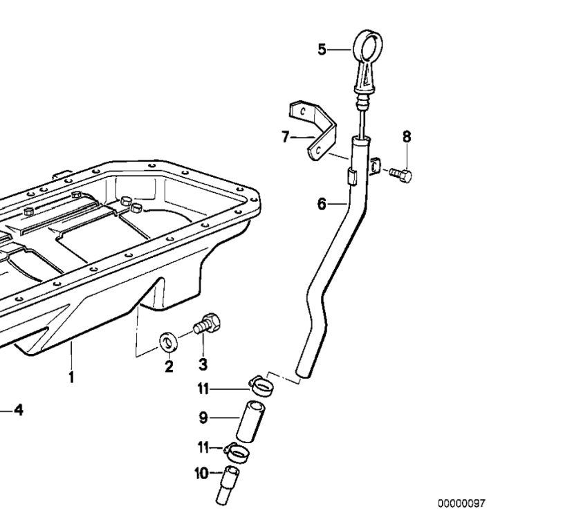

                              do you catch a lot of oil? Also return to dipstick could be a simple solution to keep it maintenance free. One can do BMW OEM design to achieve that, they way they designed a dipstick on Z1 Roadster or 325xi :)
                              Just cut the dipstick and use hose/hose clamps, BMW design after all :)
