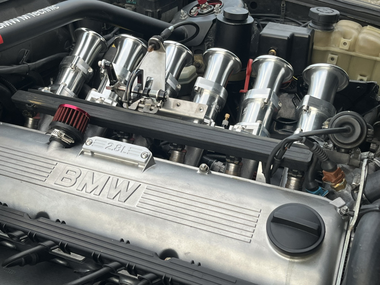

      Right now, I have the valve cover with a filtered vent (see pic), but it constantly seeps oil and smells strongly of oil vapor. So my first course of action is to run that to a catch can and move the vent to the catch can (vent to atmosphere). I already bought the catch can so that should be an easy, temporary install. I do like what you did to close off that loop entirely and drain any blowby back into the crankcase.
      I have no idea how much blowby i am getting, as i don't think there is any way to see evidence of that?
      My goal is to allow my engine to "run healthier". Seeping oil and vapors is not acceptable long term. I think your setup is the cleanest. I can CAD model most things in Fusion360 and have access to all kinds of 3D printers and high-temp materials, so maybe there is a 3D printed solution.

      M20 really had no good vacuum source for the crankcase by design, primitive PCV system. Bitch tube is just basically a crank case vent to the head /valve cover, similar to what's happening in the timing case in the chain driven engines. Valve cover vent is routed to the throttle body before the throttle plate. So like nothing that creates any significant vacuum in the crank case really.
      You definitely want to something different there. If you gonna use a catch can, you'd need to add it to the maintenance items when you do your oil changes. Avoid long lines and aluminum cans. You want to keep those vapors as hot as they are when leaving the valve cover. Otherwise your catch can will be working as a condenser and creating all kinds of mess. So Id look into plastic catch can and place it somewhere where it's warm in the engine bay, close to the motor. If driving in cold climate, maybe even insulate it. Look into Provent by mann+hummel. Probably best catch cans out there.
      The compression test is a quick way to see if your rings aren't sealing and creating excessive blow by
