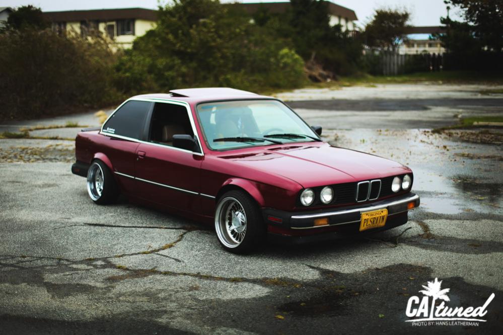

                        Oh and here's a picture of my car since I'm a stranger on the forums

                            I think those rimzzzz are a big part of your problem..... you're not gettin' the powah to da pavement....
