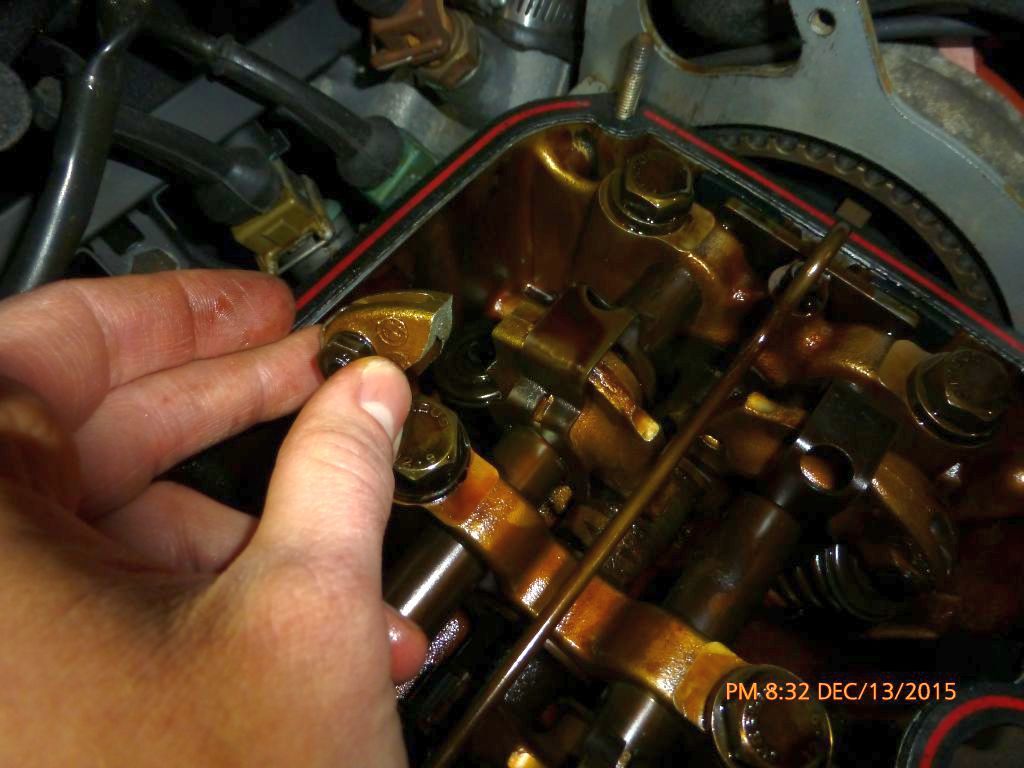

                      So I did a quick leakdown on just #1 today (was getting late and didn't wanna run the compressor too much), at 60 psi supply I'm getting around 54 psi (10% leakage), with air escaping from the dipstick. So that seemed pretty good...
                      The main news: conclusive results as to why #1 isn't firing: when I pulled the valve cover to easily check valve position, I saw found this:
                      Broken #1 intake rocker. I did have a pretty loud tick from that side of the engine, I wonder if that was related...

                        Yeah, that does tend to make it miss...
