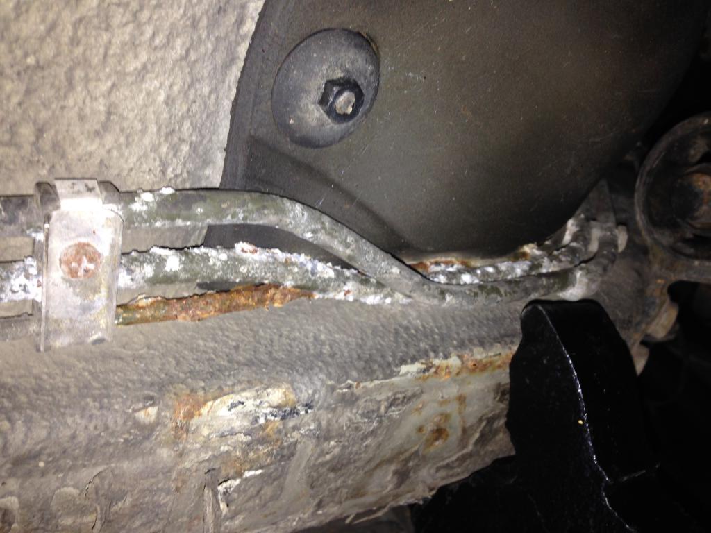

    The fuel hard lines are rusted real bad. Real OEM will give me a part number but no size for the diameter of the inside or outside of the fuel hard line. Ive read a lot about how easy it is to replace but size of tubing is never mentioned. Also read that the flow and return lines are different size.. Came to the conclusion that 1/4 inch tubing MIGHT work but i cant pull the trigger on it yet. Could there be bad side affects if there truly is different sizing and i just roll with one size throughout

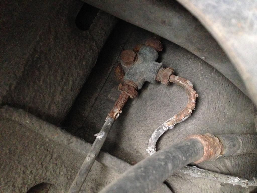

    I threw in a picture of a break line intersection. Anyone know the size for this?

    Fuel hardline is 8mm OD, 5/16" will work if you can't get metric hardline but might have to 5/16" hose with it, the 8mm hose might fit a little loose. The difference is only 0.062mm though. The return and supply are the same size, the small one is the evap line. Brake lines are 3/16" bubble flare, M10x1 thread on the fittings.

        thank you sir
