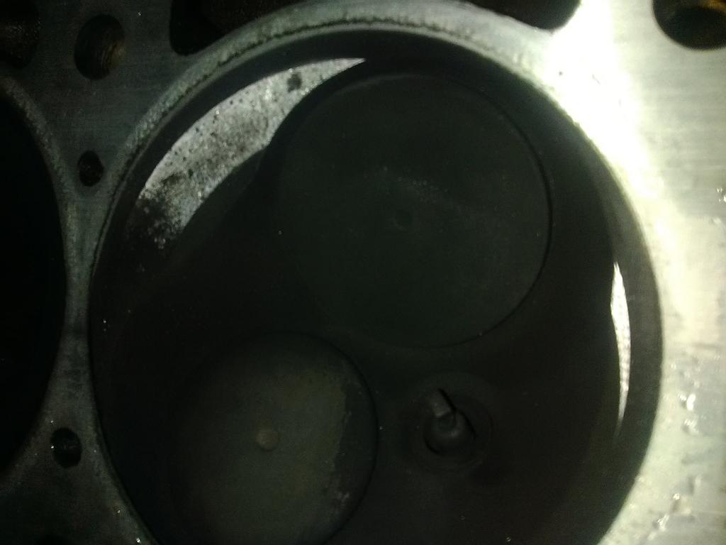

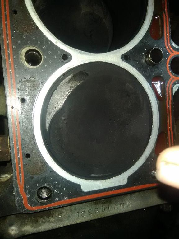

    i had a head milled and i used a erling head gasket and when i started the car it has making a loud tap noise so i tore the engine back down to find this..

    could i get a thicker head gasket or should i get a new head????
    its only on cylinder 6 and a lil on the head on cylinder 5

                    Just so I understand what I'm looking at, the piston hit the actual cylinder head?
                    AWD > RWD
                    • i_pooped
                      • Nov 2015
                      • 44
                      yea its heating the head but only on cylinder 6 and a lil on 5
