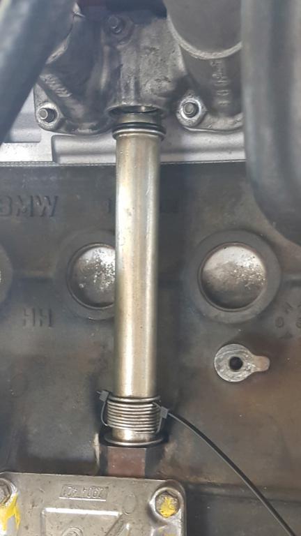

      Originally posted by ForcedFirebird
      Use mechanic's wire to compress the spring on the "bitch tube" that goes from the crank case to the intake manifold. Stack spring, washer, then o-ring top to bottom, then wrap wire on spring to keep depressed, shove it in the block (spring completely stacked), install top o-ring. This will keep the tube low enough to install/remove the manifold/top end, then cut the wire and the tube will pop up and seal at the manifold. If you forget the tube, it will not go on after the head is seated unless you remove some material from the bottom, or remove the intake from the head.
      I've always used a small zip tie, easier to ratchet tight than to twist wire tight imo.

        I'm so sick of reading about this "bitch tube". There's nothing to it. And yes it can go on with the head and inlet manifold on. Here is a photo of me doing it.
          By all means, go remove it with the intake bolted down, and show us how we all have been doing it wrong for all these years. lol
          It can't be done unless the bottom of the tube was shortened. When you push the tube down in the block far enough to clear the upper o-ring seat, the tube is too far in the block to angle it for removal (maybe with some forceful bending??). If you use a plumbing pipe cutter and remove a little material at the bottom, the cutter will put a slight curve on the end of the pipe, and it will come out. I've had mechanics forget to put them in while working here at the shop, and cutting the tube is the only way to avoid unbolting the intake.

            Indeed Forced, I just did this. I had oil leaking from this storied Tube. I had to take the entire intake manifold off. When I replaced the BitchTube I zip tied it like e30Davie and in it went. Do not see the top washer in e30Davie's picture?

              No top washer. The o-ring land will ride directly on the o-ring. The bottom needs the washer so the bottom of the spring doesn't booger the o-ring.

                Well whatever. Got mine in no worries and it wasn't cut. If it went in that means it will come out.
                      How does this prove anything? You zip tied it down and bolted in the manifold. That's what everyone does. Show me a video of you removing it with the intake in place. The bottom is too long, it has to be, otherwise it wouldn't reach from side to the other.

                        Nah I installed manifold and then installed the tube thing. Seems quite a few ppl across the internet have done the same.

                          ^^your pic is misleading. The manifold has no nuts on it.

                            It is obviously a female intake manifold... :P
